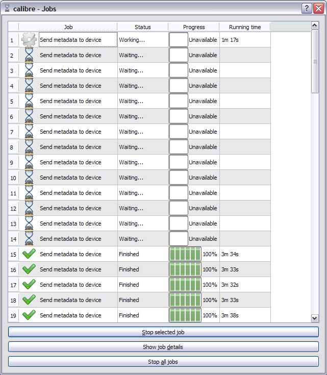

But can't it do it just once, at the end?
I paged through my collection and added a book here, a book there, another book...and it's updating the metadata for each individual "send to device". And each of those is taking more than 3 minutes (I have LOTS of books).
Could you at least consider having the metadata update once at the end of all jobs run?
It won't allow me to stop any of these "extra" jobs - so I can't even stop it.
Sorry, but that would be a very risky change. There is an excellent chance that I would break things badly.
NOTE: Windows XP, calibre 0.7.4
This is puzzling. Although the jobs clearly are taking that long, there is no fundamental reason they should, and I can't see 'coding inefficiency' reason that they would. However, there must be, so ...
If you are willing to help, could you run calibre in debug mode? Calibre will produce a log telling me in much finer granularity where it is spending the time. That could give me the necessary clues to where the time is being used.
To run in debug mode, first open a command box (start, run, type cmd in the box, and OK). In the command box, type:

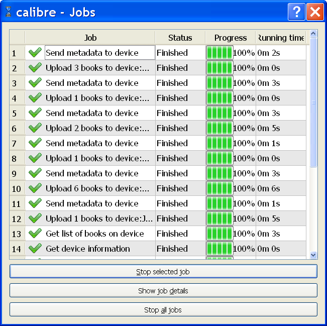

It would help a little if this was the current version.
It takes 3 seconds for calibre to grab my book list once it recognizes my device and show all books when I first connect. I then added a book here and a book there, each job took a few seconds to transfer the book and update the metadata.
I am using 0.7.5 Win XP sp3. I can't recreate your anomaly. What you're experiencing is not how it is designed to work.
Hopefully someone in the know can ask the right questions to help unravel this mystery.
Update: I see while I was twiddling my thumbs browsing the calibre manual that chaley has given you guidance. Hopefully y'all can work this out.
