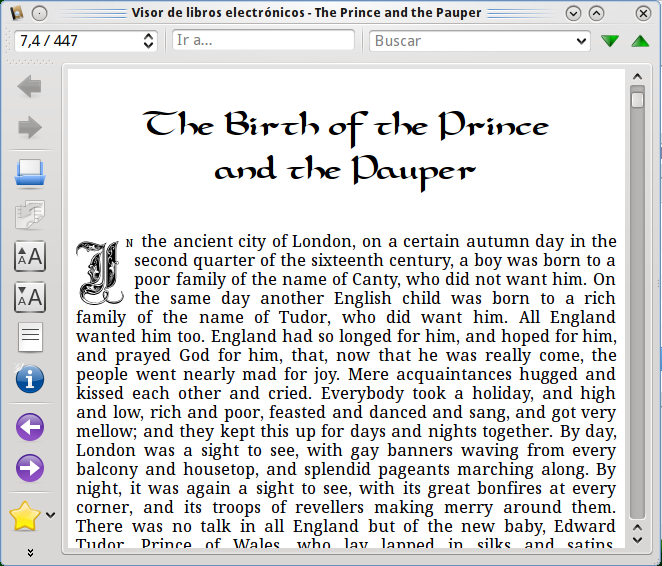

Is that the css inside the book or the "user css" of calibre viewer? The second is what I was asking about.
Then, one should make sure the font names specified are the correct ones, in the case of embedded fonts they should match the names given in the @font-face, for system-installed fonts, it could be anything.
But I can tell you calibre (0.7.0) can work with embedded fonts, as the attached screenshot shows. The title and drop-cap fonts are embedded in the ePUB, and they are not installed in this computer. If you are worried about embedding an un-obfuscated version of a commercial font, try with a free font instead and post a sample file, please.

Originally Posted by Valloric View Post
The reason why calibre is having problems displaying embedded fonts is because QtWebKit has problems displaying embedded fonts.
See this bug.
That bug is the #1 reason why Sigil doesn't have explicit font embedding support.
That bug is indeed very annoying, but it is possible to get around it by modifying the embedded fonts so that they all contain distinct font family names. I did that for the ePub available here, and now it supports all the font variants in calibre's viewer.
But I don't think this is the issue here. Brewt isn't getting any of the fonts in the family to show.
