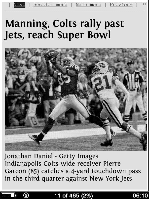

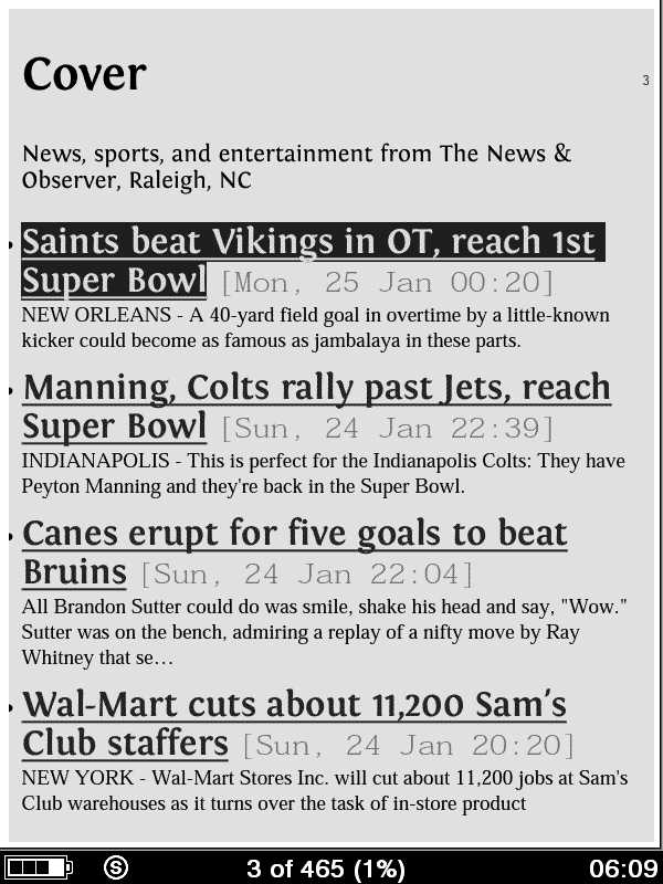

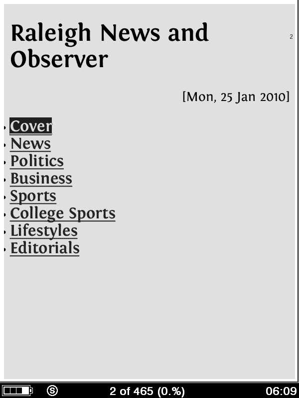

Originally Posted by lenik View Post
was the problem with getting dozens of files for every news feed actually solved in any of these 35 versions?
Since I have no clue what you're describing it might have been fixed. As an example I download my local newspaper, the recipe has 8 separate feeds and I end up with one epub document that contains them all.
See the attached for screen shots of how this epub (containing 8 feeds) looks on my device.
ID:	50177   Click image for larger version
ID:	50178   Click image for larger version
