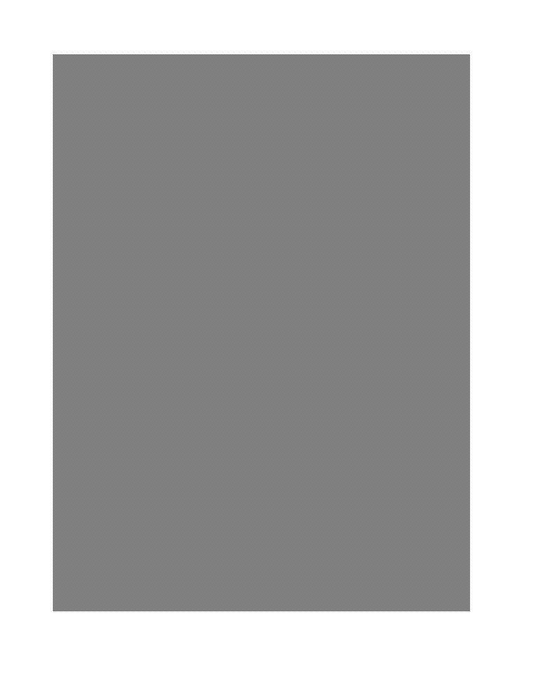

So, I was hoping the 2.0 firmware would fix an issue I've been seeing, but it didn't seem to change anything.
I generate EPUB files containing full screen images, they're rasterized aviation charts. On other devices I can coax them(with CSS and properly sized images) to display 1 pixel on the PNG to 1 pixel on the screen. However, nothing I can do on the iRex DR800SG with the original or the beta firmware changes it's seemingly arbitrary handling of images in EPUB files. I get different image sizes based on my font settings even when CSS requests an image the full width of the screen. And then the images are always scaled somewhat.
I've attached a sample, ideally it should either be the full width of the display or 1:1. I can deal with either, but not whatever it seems to be doing.

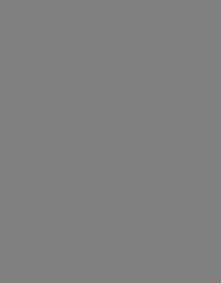

I can confirm this. I couldn't get an image to display 1:1 even if I set No Margins and the image was the exact visible screen size (768x981). In that last case it was shrunk so that there was a quarter inch on each side.
Even viewing the raw PNG you can't get 1:1 unless one or both dimensions are exactly the visible screen area (either 768 width or 981 height).
Attached is the test pattern image from the original ePub pasted into a 768x981 white space image. It views correctly 1:1 viewed as a PNG, but if you put it back into the ePub it won't, even with No Margins selected in the Settings.
Also included is a full 768x981 test pattern so you can see that it fills (or doesn't fill) the viewable area.
ID:	49653   Click image for larger version
Previously it was found a font size setting other than the default (medium I think) would incorrectly affects image sizes as well, even when those images are set for specific dimensions in the document. See if changing the font size setting makes a difference.
Default used to be Small. It's Medium in the beta (thank you, iRex). It comes up slightly scaled in Medium and gets worse in any other font size setting.
Medium was just 'close to 1:1', I don't think anyone actually confirmed it was truly 1:1. The lack of the ability to do 1:1 in an ePub is what made me write the CBZ plugin in the first place.
It gets better though, the iRex is the ONLY device that applies the font setting to images using pixel height/width when using the ADE SDK. I filed a bug via iRex support and got it blamed on Adobe not once but twice.

We will look into this scaling issue in EPUB.
There are several ways of scaling/zooming/reflowing an EPUB using the RMSDK, it appears we may need to use another way...
