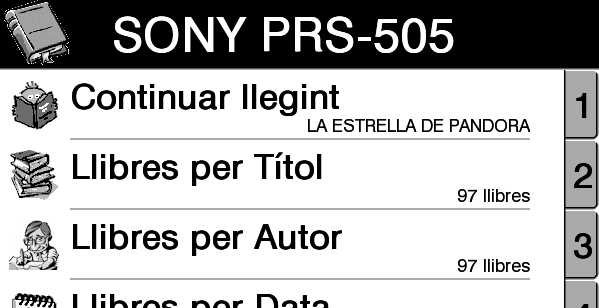

Other customizations are available:
1 - TEXT in title of main screen (compatible with Custom logo). See example in attached thumbnails.
2 - Modify animation when the reader thinks. See examples and download files in http://prs-505.webcindario.com/imatges/kbook.htm
My reader: http://www.youtube.com/watch?v=57CAWooty-s
Everything is compatible with PRS +, I have it installed on my mod
Name:	main screen.jpg
Where exactly do you modify to get this?
Thanks for the icons and the animations they work great.
