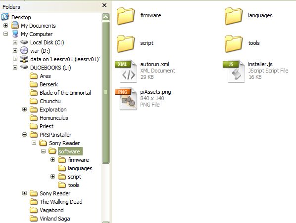

Sorry to be thick, but i don't seem to remember having an issue with this before;
unzipped the PRS Installation zip to my PRO DUO card (via the reader- My Computer).
removed the card, then re-inserted the card. But no install screen to copy files to my device.
I have done a bit of searching and I found a few instances of a missing
\database\system\PRSPlus
folder, but I have checked my Internal device folder structure and its there alreight (or would this refer to the card?
Of worthy note is that my card is not clean, I have several folders that contain my ebooks, and a Sony Reader folder that contains the xml for the card.
SD/MS card scanning is enabled on my device.
Would I need another installer on the card also or will the PRS+ installer folder contain the files I need in itself?, the notes ont he google development site dont say anything other than move the contents of the zip onto the card.
Thanks in advance for any assistance,
I could imagine that there is a manual installation also is this simple to do in laymans terms?
If you did that right after enabling SD/MS scan, sometimes nothing happens, if you did it too fast.
PRS+ Installer's first screen looks like this:
Other folders could not be the problem. (unless you have too many of them/ use non Latin letters, so that the reader bugs and doesn't see part of the filesystem)
The folder structure on your MS/SD card after extracting the installer should look like this:
├─PRSPInstaller
│ └─Sony Reader
│   └software
│     ├─firmware
│     │ └─505
│     ├─languages
│     ├─script
│     │ └─addons
│     │   ├─FiveBalls
│     │   │ └─skins
│     │   ├─Mahjong
│     │   │ └─skins
│     │   └─Sudoku
│     │     ├─skins
│     │     └─sudoku
Software folder should contain the following files:
installer.js
autorun.xml
As you are the first user that tries to install it using memory stick, it could be that there is a bug in installer code that prevents it from starting from MS card.

hmm,
I think that this is a personal issue with my device rather than a bug on your install, although I might be wrong.
I just tried to install via SD card and I still get no install menu prompt. I have re-inserted and disconnected a few times, leaving a few minutes for the card to be read/removed.
Should I not have any root files other than the PRSPInstaller folder?, so the autorun files are run via the folder not the root?

sideburnt
Nah, you can have have root folders/files, it should matter.
Very strange. Is PRSPInstaller folder visible via Browse Folders? Does it contain all necessary subfolders as mentioned in post #707? If yes, sounds like disabled SD/MS card scanning, but you say you've enabled it...
Anyway, extract the attached file to your /database/system/PRSPlus/addons folder on internal memory. Then go to Games & Utilities menu, prs+ installer should appear there as an option.
PS
If it stucks instead of opening the PRS+ Installer, don't worry, just connect reader to USB port, if that doesn't help, reset, the problem will be gone.
File Type: zip PRSPInstaller_Starter.zip (424 Bytes, 259 views)

Thanks for the javascript file Kartu, when I place it within the Internal structure, the menu item appears, however when I click on (3) for the PRS+ Installer I get the little (-) icon flash at the bottom of the reader for 'invalid command'

sideburnt
It means that it couldn't find the file (or one of the required files) on sd card:
"/PRSPInstaller/Sony Reader/software/autorun.xml" (or file was damaged)
Sorry, I forgot to mention, it could only be used to start it from SD card. If you want to start it from MS card edit the following line:
kbook.autoRunRoot.path = "b:/PRSPInstaller/Sony Reader/software/autorun.xml";
and replace b:/ with a:/
Could you please post a screenshot of what you have in:
"/PRSPInstaller/Sony Reader/software/"
folder?
PS
You might need to reset the reader (if just connecting to PC won't help) to get rid of an invisible installer frame that wasn't fully loaded.

here is a screenshot of my card contents at the folder you specified.
Just tried to run the installer and my device hung, just trying to reset the device.
