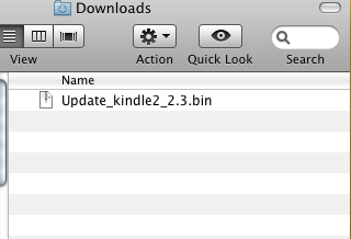

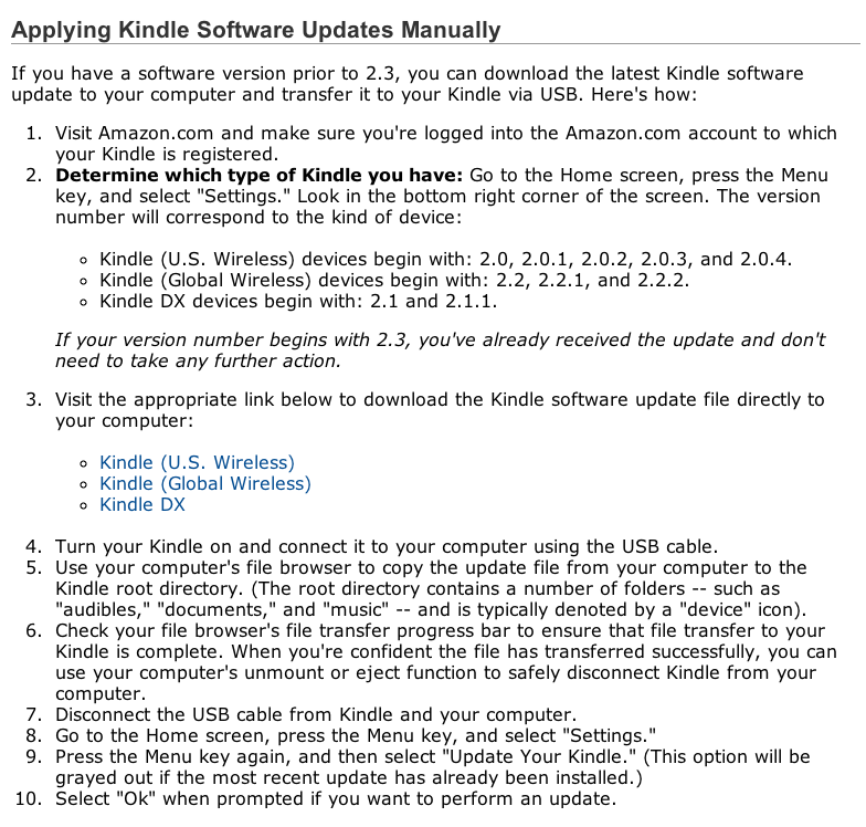

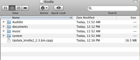

The new update is currently not a part of the reset file. If you simply do a factory reset you will have 2.0 and not 2.3 on your Kindle2. Make sure you have a copy of all your ebooks currently on your machine. I just did a factory reset this morning and had to download 2.3 all over again. This is for those who want to go back.
Download off Amazon (I have a MAC) and put file on your Kindle.
