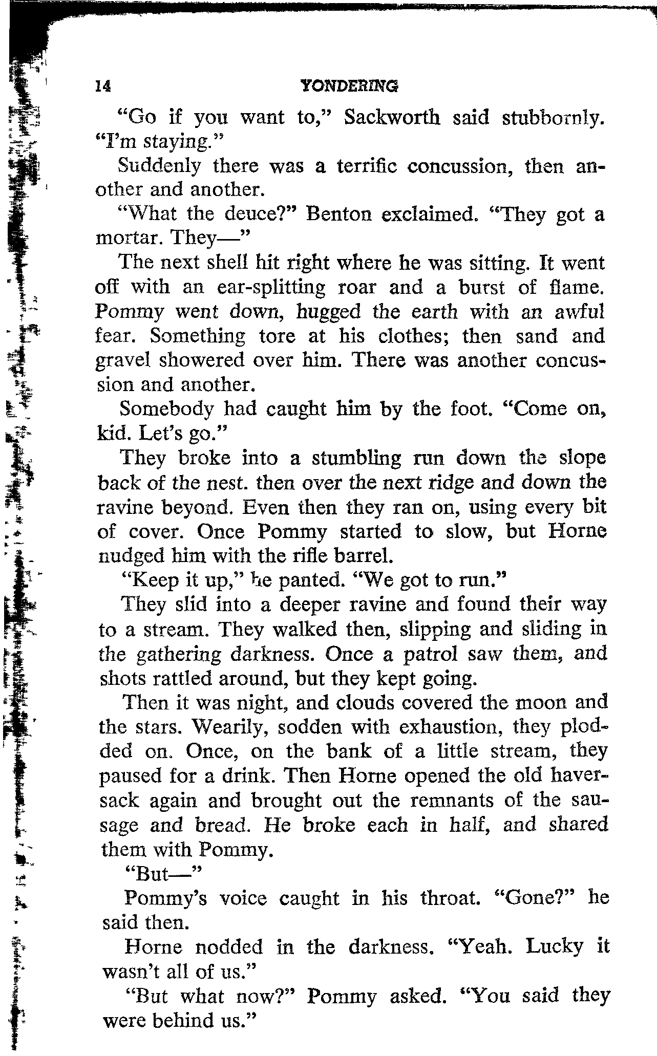

Attached a sample of running unpaper. The tricky thing is knowing what options to provide as default to the user....
ID:	3226   Click image for larger version

ok. I think i'll default to pnmcrop for plain autocropping and have an unpaper option for scanned/noisy pdfs. We'll see what options have to be included, but with the preview feature it shouldn't be difficult for the user to figure out the right settings.
