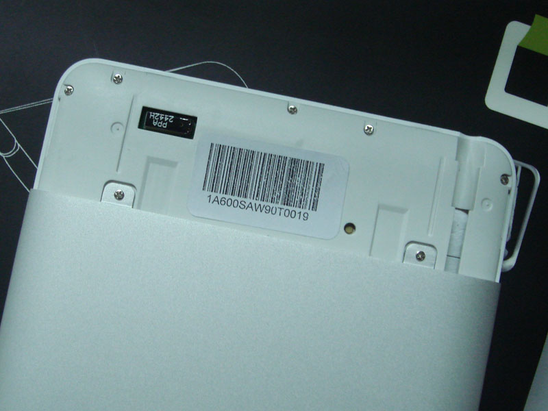

There is a bug in the first firmware, and that's why the unit is frozen in standby. You'll need to update the firmware to the latest one. The firmware and instructions can be found on the Onyx website.
You'll need to reset the frozen one before you can install the update, and that involves taking off the back cover. First remove the stylus. Then lay the unit screen down. The white plastic back slides up off the device.
At this point I want you to try the reset button and see if that fixes the problem. It was uncovered when you removed the plastic back. There is a recessed circle . You'll need a screwdriver.
The metal back is attached by 2 tiny screws. After you remove them, the back slides down. Unplug and plug in the battery.
You're done. Reattach the covers.
Nate,
This is really great. I didn't have to unscrew the metal cover. Just hit the reset below the top white cover and it WORKS !!!!!
THANKS once again. YOU are a GREAT HELP !!!

I have a picture of the back off showing the reset button. just take the pen out and then slide the plastic open
