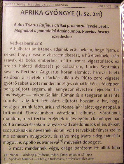

Arturo
Arturo began at the beginning.
Arturo's Avatar
Posts: 18
Location: Europe
Device: Koobe (Hanlin V3)
Originally Posted by Dave_S View Post
Maybe, but I only read fiction novels without footnotes.
I find footnotes quite useful. If there is a comment/explanation/translation to some part of the text it is beautifully shown at the bottom of the page, just like in pbooks. See attachment. This is of course personal preference.
Several free books contain footnotes and while they are handled well in CR, not in FR.
...when it finds an FB2 markup that it can not handle...
How do these get into the FB2 file? I am really curious, because I never saw this problem in any of my ebooks. It seems OpenOffice.org FBTools does its job fine.

Originally Posted by orwell2k View Post
Interesting - what do you use to generate your FB2 files? I use BookDesigner and it doesn't seem to add any unusal markup that CR can't handle. I believe OOoFBTools also does a decent job. Some of th other converters I'm not so sure about. I have had no success with the Calibre FB2 output.
I also use Book Designer to build FB2 files. I use it to create an FB2 and an HTML file from my original source material. I use the HTML output of BD as the input to Sigl to create an EPUB file. OI and FBReader has always handled both those files just fine for me. I only run into CoolReader problems with *some* files and it is usually a problem with a character that can not be displayed with CoolReaders character set. When I find CoolReader skipping paragraphs, I have to load the FB2 file into a text editor and find the character that caused CoolReader to abort the paragraph. I can then do a global search and replace to replace the offending character with one that CoolReader will accept. I do not have any such problems with FBReader. I am stuck using CoolReader with the Hanlin V5, but with my Hanlin V3 running OpenInkpot I have no problems with FBReader, so that is my preferred reader at the moment. FBReader also has an advantage for me in that it can be configured with a popup menu in OI, so I do not need the extra step of making an FB2.css in in the .crengine folder like I need to do to get CoolReader to work the way that I want it to.

I see now. I was deceived by the word "markup".
Can you tell what characters are that CR will not handle?
