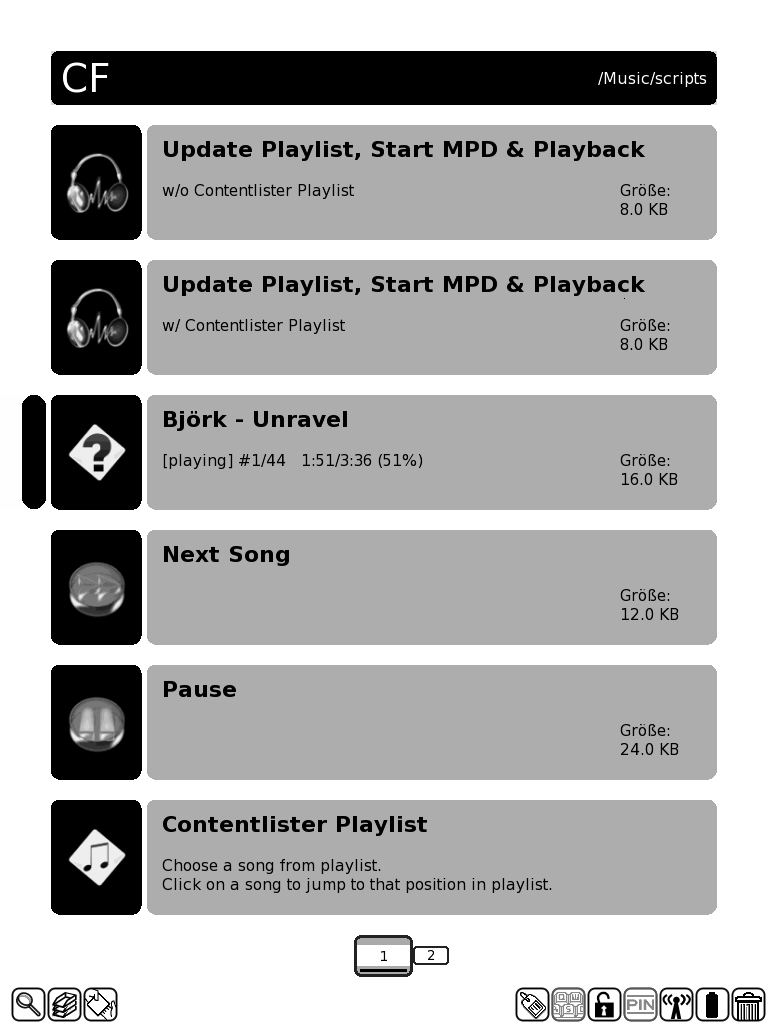

I've setup a series of scripts to allow you to play music through the contentlister. It uses a program called MPD. MPD is a music player daemon, the same one used in the ipodlinux project. It's small, lightweight, and easy to use.
I've compiled it with the following Format Support:
File Format Support:
ID3 tag support ...............enabled
mp3 support ...................enabled
Ogg Vorbis support ............enabled
using tremor.................no
Wave file support .............enabled
MOD support ...................enabled
It's controlled via a series of shell scripts. But, this allows it to play music in the background while you do other things (read, play chess, etc). I've tested it a bit, and as long as the bitrate is pretty low, you won't see any skipping. Otherwise, it may skip for a split second when you turn the page.

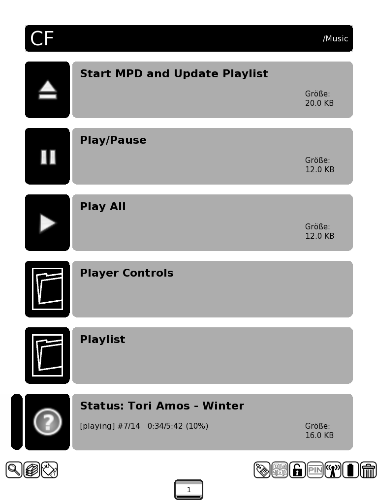

Adam B.; your scripts can't work, because all your .sh files have windows encoding "CR LF". iLiad's contentlister needs Unix encoding "Line Feed only".
After changing CR LF to LF, scripts are working now for me.
[Edit I] Maybe somebody should update the .sh files. ;-)
[Edit II] files got an update.

I just checked the download of post #1. Both zip files got an update. Line Feed bug is history.
[Edit:] As a positive proof I attached a screenshot; greetings to all fans of Tori Amos out there.

This creates a top entry "Music Box"-"Click on me to jump to MPD directory" in
Contentlister.
**Usage**
[1] Copy music files to folder "mp3" on your CF,SD,MMC.
[2] Search for "Music Box"-"MPD Playlist Script" in Contentlister.
[3] Click on "Update Playlist, Start MPD & Playback" to start playback.
[4] All other buttons are self-explaining. ;-)
other entries:
"Link to Button Scripts" -> e.g. link news button to Music Box
"Contentlister Playlist" -> choose a song to skip to
**What I have changed & added**
[1] Reorded script entries in Contentlister
[2] new covers, manifest.xml
[3] "Update Playlist" script starts playback
[6] now 2 "Update Playlist" Scripts: w/ & w/o Contentlister Playlist
[4] Combined pause/play button
[5] "Update Playlist", "Previous Song", "Next Song", "Pause/Resume" update the
Status message
[6] Contentlister Playlist:
# removed no-cover bug [manifest.xml likes only relative cover image path]
# removed mudlle [#1,#10,#11,...,#2]
[5] added scripts "Symbolic Link to the 4 Hardware Buttons"
Have fun with your little iLiad,
yokos
[very OT]: on screenshot pagebar is above toolbar.
