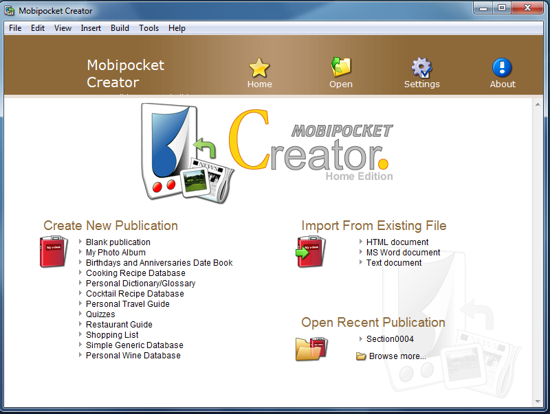

I already had mobipocket creator installed. I ran a html file through it first as suggested and made a prc which worked fine but sadly, I didn't find the import feature on the home page as you mentioned.
This would be a good work around because exporting from PDFs that have been cropped to remove folios still includes the folios. The cropping just masks the output. The content is still there. Though invisible until you export it.

OK . . . Thanks. I think.
However, how can I proceed without the import option being available as pictured above?

There are 2 editions of mobi creator - you need the 'publisher edition' not the 'home' edition.

Cool . . . I'll give it a go. Thanks
