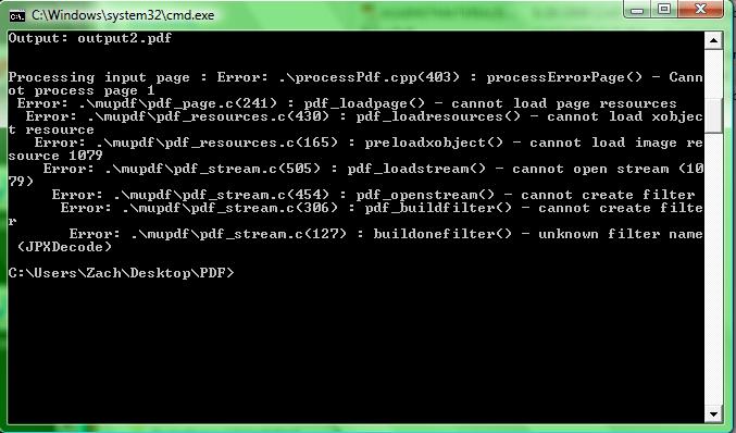

There is your problem. When you renamed you're file you called it "Input.pdf.pdf"
type this command instead
sopdf.exe -i input.pdf.pdf -o output.pdf
or rename the input file
Prompt> move input.pdf.pdf input.pdf
Prompt>sopdf.exe -i input.pdf -o output.pdf
What happens is Windows Explorer has this "feature" that hides the extension. When you rename a file and think you added an extension it does not your only adding the filename.
The command line however does not do this and requires the exact file name.
I hate that feature and disable it immediately.

Ouch. Can't believe I didn't notice that.
I tried another file and this one didn't work. (See attachment.) What can I do when a file doesn't work? It looks fine in PDF reader.
Also, how can I make it so the output is in portrait rather than landscape?
I like that you put "feature" in scare quotes. "Annoyance" would be more like it. (Luckily you can turn it off.)
I think there are some PDF versions soPDF just can't handle. Not sure if that's what you're seeing or what.
Try experimenting with the "mode of operations" options. That is, instead of what you had before, do:
("Fit Height x2")
sopdf -i input.pdf -m1 -o output.pdf
or
("Fit Height")
sopdf -i input.pdf -m3 -o output.pdf
Actually now that you've got it working for at least some files, you could also try the GUI again, and see if it works at all.
