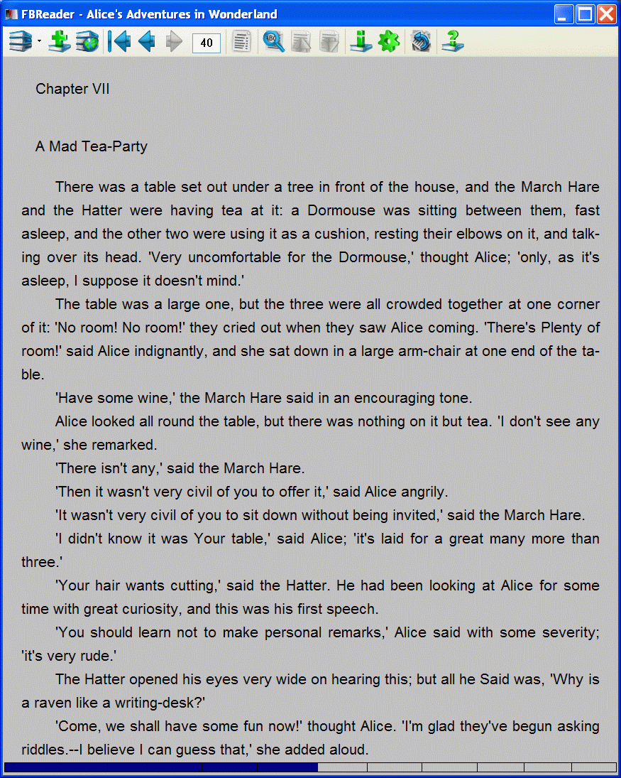

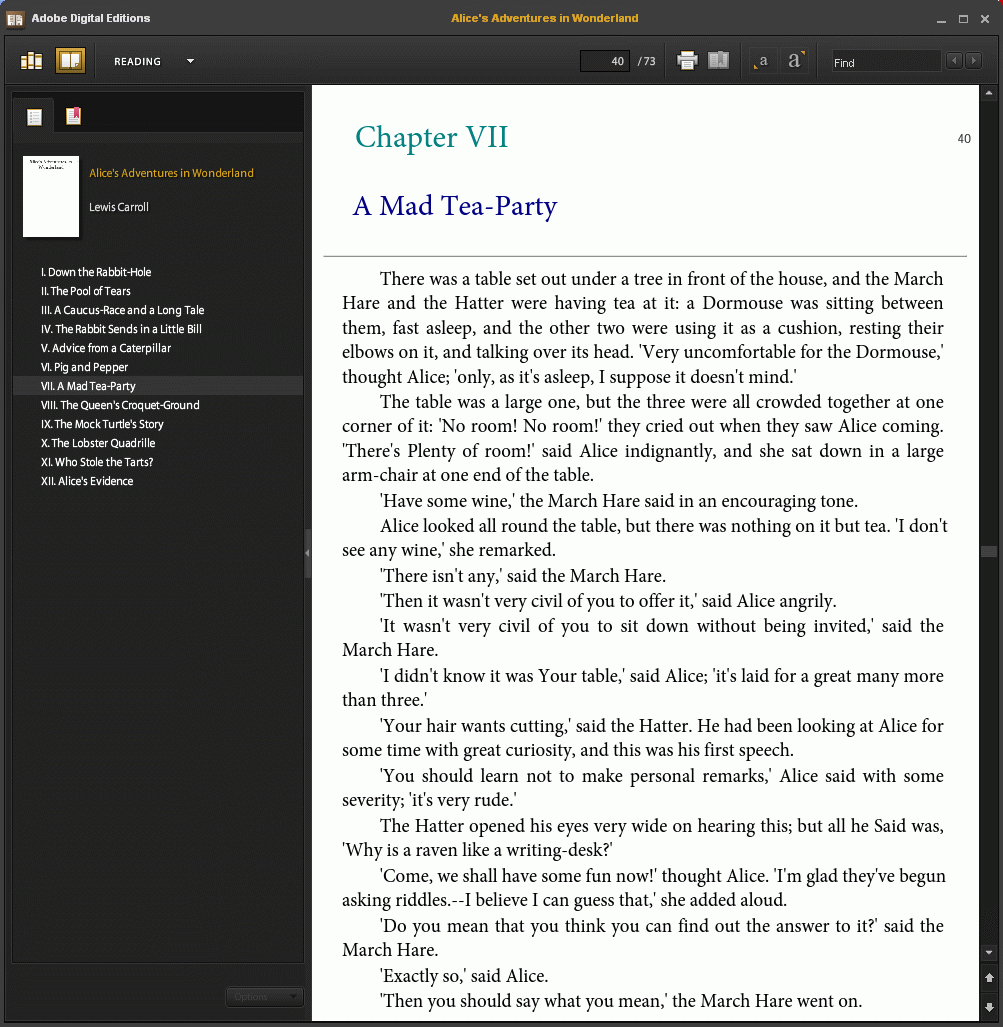

does fbreader have decent support for ePubs that use css?
zerospinboson is offline   Reply With Quote
Old 06-07-2009, 06:31 PM   #12
wallcraft
reader
wallcraft's Avatar
Posts: 6,977
Karma: 5183568
Join Date: Mar 2006
Location: Mississippi, USA
Device: Kindle 3, Kobo Glo HD
It has limited support for CSS, and no support for SVG. You can try it out on a Windows or Linux Desktop. See the attached screenshots from an ePub of Alice in Wonderland on a Windows PC using Adobe Digital Editions and FBReader.
ID:	30440   Click image for larger version
