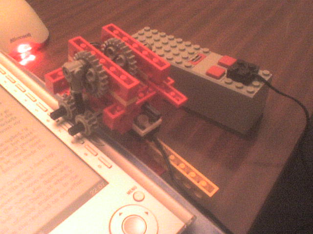

Hope the Automatic page turn mod comes to fruition, in the meantime see my Automatic page turn / remote Working Prototype device:
https://www.mobileread.com/forums/showthread.php?t=56009
