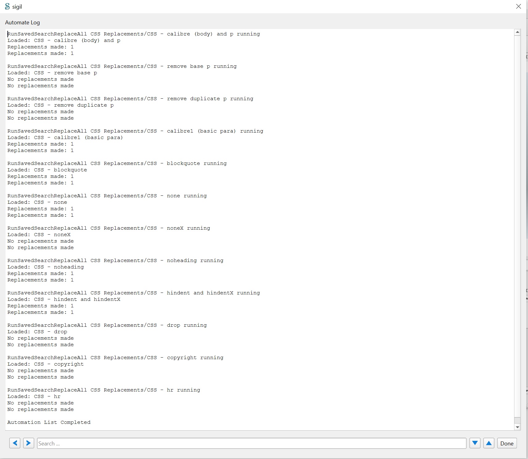

I tried the "All CSS" setting, and it didn't work. In fact, it return NO results unless I ran the automated list in the css file in question. As you can see in image AL_03, when it ran the list in a file other than the css file, despite having selected "All CSS", it ran the list as "All HTML", bizarrely.

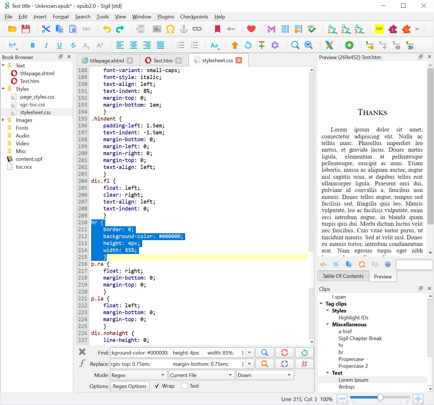

The other attached images are:
AL_01: which shows that as a standalone search (i.e. not automated), the "CSS - hr" search does work (in "current file" mode or the key board shortcut for searching within the current file).
AL_02: which is the log for the automated list when it is run with "Current file" selected and the css file open. The same result is displayed if you run it with "All CSS" (or its ilk), but ONLY if you have that file open in the viewing tab. Otherwise, as I said above, it yields NO matches.

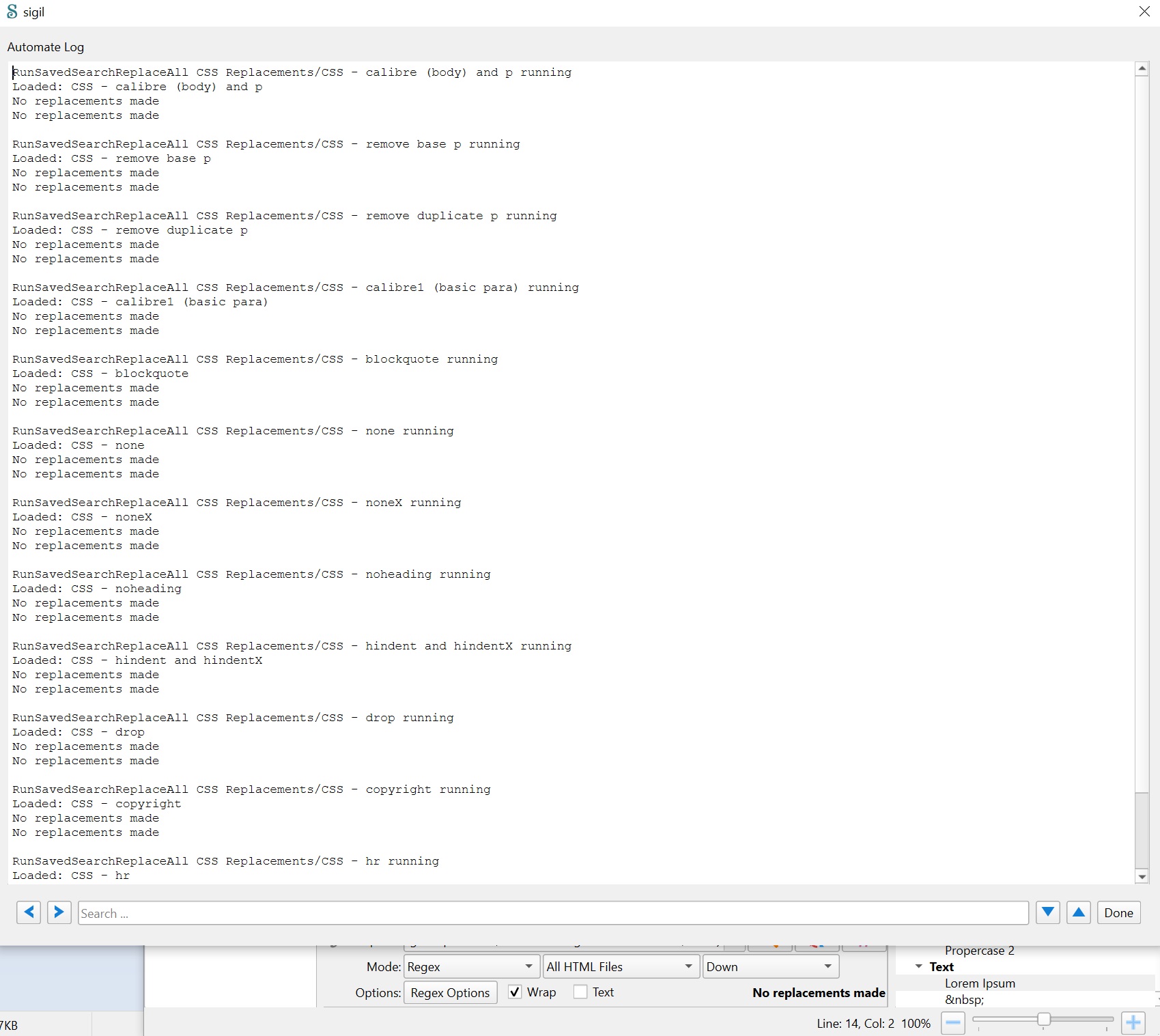

A couple of additional notes:
1) You will see that in AL_02, the second-to-last search—"CSS - copyright"—similarly had no matches or replacements. It is like the "CSS - hr" search in that it too will match when the search is run discreetly and in "Current file", but will fail when it's run as part of the automated list.

Your replacements file shows that your hr css search was done with the control value AH as target:
14\Name=CSS Replacements/CSS - hr
14\Find="hr {\n\tborder: 0;\n\tbackground-color: #000000;\n\theight: 4px;\n\twidth: 85%;\n\t}"
14\Replace="hr {\n\tborder: 0;\n\tbackground-color: #000000;\n\theight: 4px;\n\twidth: 85%;\n\t}\nhr.hrsep {\n\tborder: 0;\n\tbackground-color: #000000;\n\theight: 1px;\n\twidth: 4em;\n\tmargin-top: 0.75em;\n\tmargin-bottom: 0.75em;\n\t}"
14\Controls=RX WR DN AH
The target set to AH means all html files. The target should have been AC for all css files.
Please edit that search in your Search Editor and edit the Controls field and snap a screen shot of your target. Perhaps that Controls widget is broken somehow? If you select "All CSS" files the AC control should be set in your saved search not the AH.
What appears after double clicking in that control field in the saved search editor and setting the target to All CSS files then clicking outside the controls to save it?

Old 11-20-2025, 09:57 PM   #9
KevinH
Sigil Developer
Posts: 9,419
Karma: 6733754
Device: many
In fact when I use the Fill controls to "fix" your set of controls to use ALL CSS instead of Current File or All HTML, and run it I get the following log file:
RunSavedSearchReplaceAll CSS Replacements/CSS - calibre (body) and p running
Loaded: CSS - calibre (body) and p
Replacements made: 1
RunSavedSearchReplaceAll CSS Replacements/CSS - remove base p running
Loaded: CSS - remove base p
No replacements made
RunSavedSearchReplaceAll CSS Replacements/CSS - remove duplicate p running
Loaded: CSS - remove duplicate p
RunSavedSearchReplaceAll CSS Replacements/CSS - calibre1 (basic para) running
Loaded: CSS - calibre1 (basic para)
RunSavedSearchReplaceAll CSS Replacements/CSS - blockquote running
Loaded: CSS - blockquote
RunSavedSearchReplaceAll CSS Replacements/CSS - none running
Loaded: CSS - none
RunSavedSearchReplaceAll CSS Replacements/CSS - noneX running
Loaded: CSS - noneX
RunSavedSearchReplaceAll CSS Replacements/CSS - noheading running
Loaded: CSS - noheading
RunSavedSearchReplaceAll CSS Replacements/CSS - hindent and hindentX running
Loaded: CSS - hindent and hindentX
RunSavedSearchReplaceAll CSS Replacements/CSS - drop running
Loaded: CSS - drop
RunSavedSearchReplaceAll CSS Replacements/CSS - copyright running
Loaded: CSS - copyright
RunSavedSearchReplaceAll CSS Replacements/CSS - hr running
Loaded: CSS - hr
Automation List Completed
So everything appears to be work as expected. If you only want to run on a single css file instead of all of them then use "Tabbed CSS Files" or "Selected CSS files" as your target and make sure you have selected or opened in a tab the css file you want before running the automate list.
All appears to work.
Old 11-20-2025, 10:03 PM   #10
