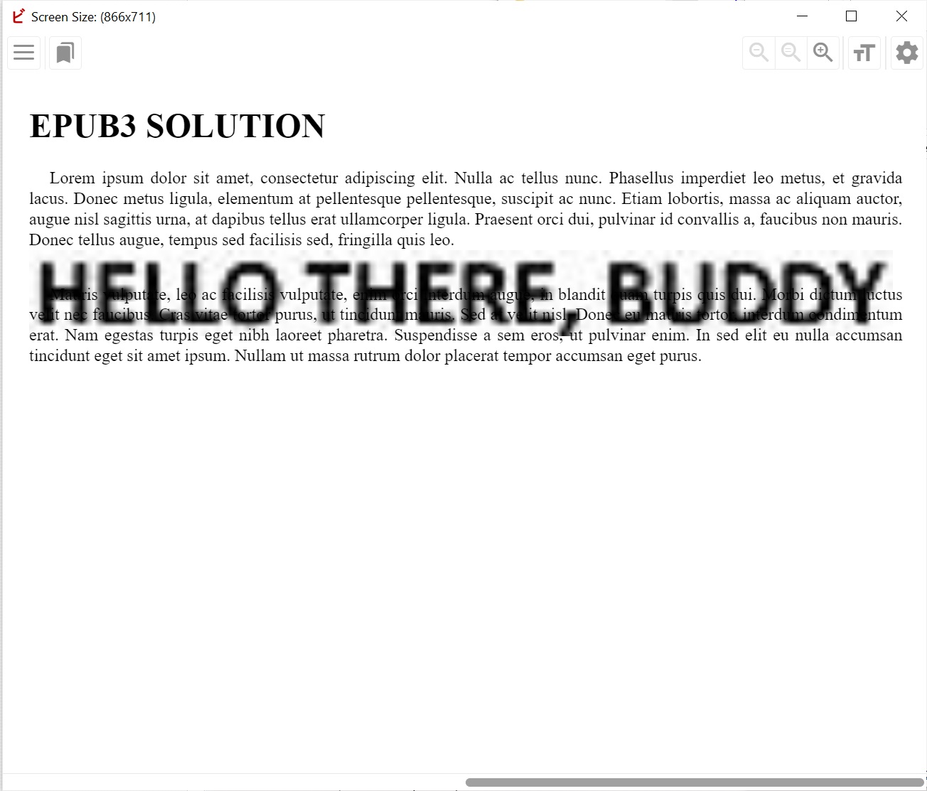

a) if the window is narrower than would accommodate a 2em height and proportional width (e.g. the WINDOW width is equivalent to 11em), the image is shrunk to fit the screen width-wise, maintaining a proportional height (i.e. resulting in an image that functionally has a height of 1.8333em and a width of 11em).

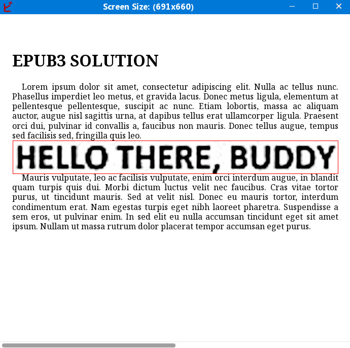

b) if the window is wider than the proportional width of the image at a height of 2em (e.g. 14em wide), it will honor the 2em height with proportionaly width (resulting in 1em of white space to the left and right of the image).

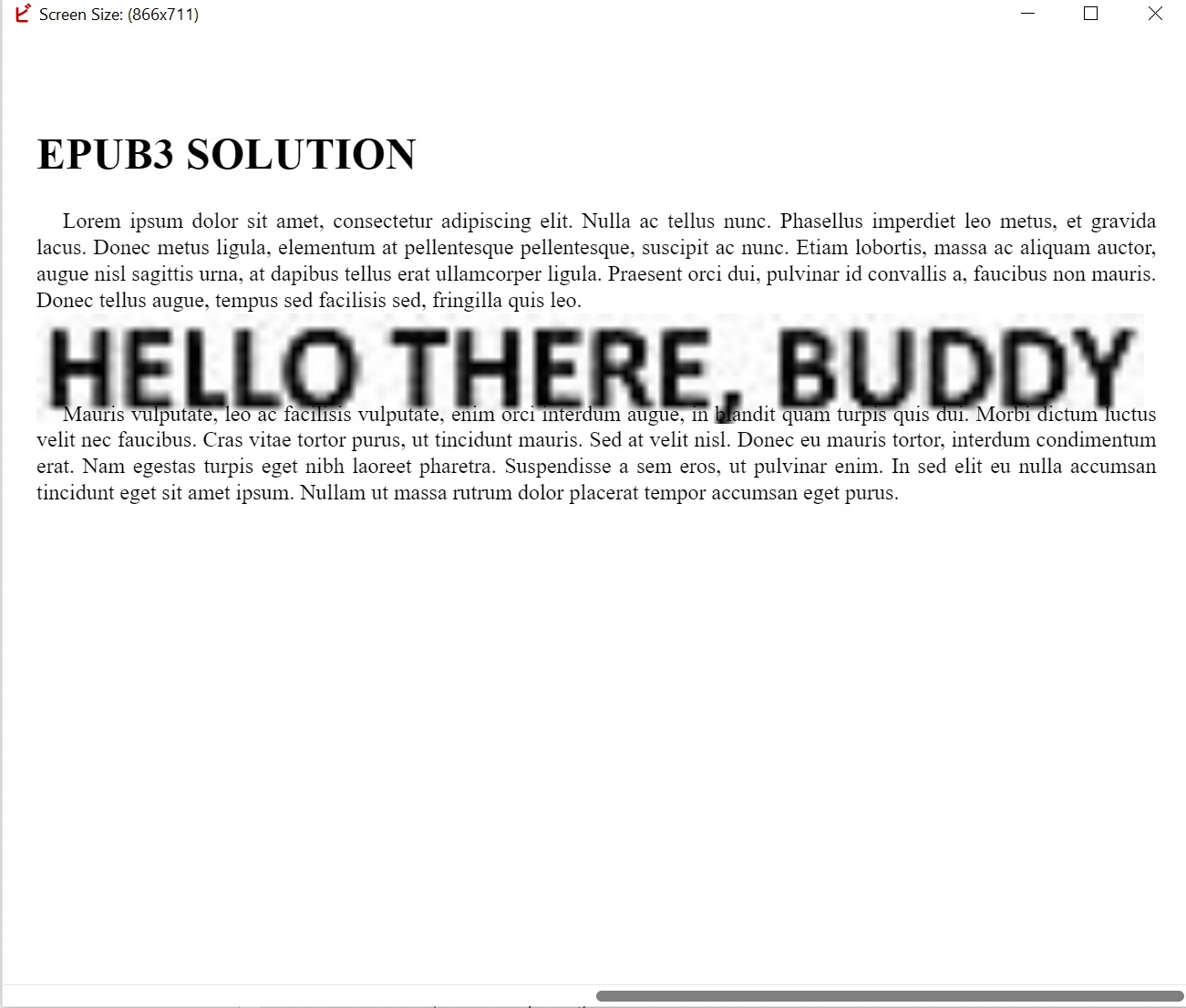

c) if the window matches the proportional width of the image at the defined 2em height, it would would look like scenario a, except the image would be exactly 2em (as defined) rather than shrinking to fit the window.
I add a border to the image so you can understand better the things. As you can see, you have everything you asked for.

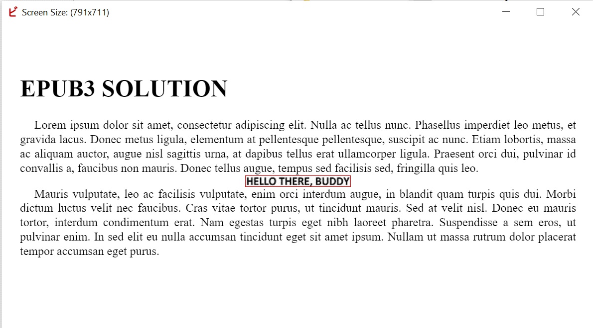

For the epub3 solution,
at a max height of 4em these are the results I get when the window is wide:

In all cases, it doesn't seem to care about the max-height value (at least not for determining the height of the image). It just keeps growing to fill the window width-wise.
