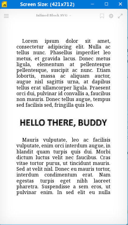

In your initial post you wrote:
In the Kindle OS, images with a fixed height (and no specified width) that would exceed the screen width are resized proportionally to fit the screen width. In other words the fixed height is functionally overwritten to fit the image proportionally to the screen if honoring it (proportionally) would result in the image's exceeding the screen width. Otherwise, the fixed height value is honored as long as the implied image width is less than the width of the screen.
Well, there's no way to do this without generating white space when the image's height is greater than its width. If the image's width is greater than its height, then the solution for epub2 based on an SVG container is the correct one, and it doesn't generate white space, unless it's due to margins or padding. And under epub3, the solution is even simpler: give the image "max-height: 4em" and "width: auto."
  <p>Lorem ipsum dolor sit amet, consectetur adipiscing elit. Nulla ac tellus nunc. Phasellus imperdiet leo metus, et gravida lacus. Donec metus ligula, elementum at pellentesque pellentesque, suscipit ac nunc. Etiam lobortis, massa ac aliquam auctor, augue nisl sagittis urna, at dapibus tellus erat ullamcorper ligula. Praesent orci dui, pulvinar id convallis a, faucibus non mauris. Donec tellus augue, tempus sed facilisis sed, fringilla quis leo.</p>
  <p class="autoImg"><img alt="Hello" src="../Images/Hello.jpg"/></p>
  <p>Mauris vulputate, leo ac facilisis vulputate, enim orci interdum augue, in blandit quam turpis quis dui. Morbi dictum luctus velit nec faucibus. Cras vitae tortor purus, ut tincidunt mauris. Sed at velit nisl. Donec eu mauris tortor, interdum condimentum erat. Nam egestas turpis eget nibh laoreet pharetra. Suspendisse a sem eros, ut pulvinar enim. In sed elit eu nulla accumsan tincidunt eget sit amet ipsum. Nullam ut massa rutrum dolor placerat tempor accumsan eget purus.</p>
And the .css is:
.autoImg {
  text-indent: 0;
  max-height: 4em !important; /* Try changing here the max-height to 25em to see what happens*/
  width: auto !important;
  margin: 0;
.autoImg img {
  display: block;
  width: 100%;
  margin: 0;
See the attached epub with the solution for epub2 and epub3. Open the epub with any ereader and increase/decrease the width of the ereader to see how the image is displayed.

In that case, with a image wider than highter, the solutions you can read in the last epub I uploaded will work for you; images won't have any blank spaces and they will maintain their proportions. But under epub3, don't set the height by the "height" property, instead use "max-height: 2em; width: auto" and all of your conditions will be satisfied.
Sorry @RbnJrg, I've been away from my computer for a week, so haven't really had a chance to play around with this until now.
For the epub2, it doesn't honor a specific height (as the value there is set to "auto") making it ALWAYS 100% of the width of the window. (unless of course I change that value to Xem, in which case it runs the risk of the white space above and below if the screen is too narrow for the image)
For the epub3 solution, it's a little funkier still... Changing the max-height value doesn't seem to have any effect at all—4em (as it is set in the original file) and 2em (as you said above) render the image exactly the same: always 100% of the width of the window, at a proportional height. Even more bizarrely, setting it to 1em results in the image's overlapping the paragraph below it.
