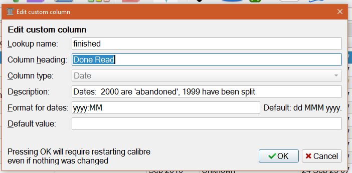

That image implies a simple Text column with no limits on what can be entered.
This puzzles me on why you cant type any number you want.
right click on the column Head: Do you see Edit column definition? (only on user columns). You might have options
(note changing a column TYPE is not allowed. You would need to create a new column, then transfer existing date. MDE Bulk mode Search and replace)
If you had selected Text with a fixed set of permitted values, The permitted values can be modified.
If you had made it a Date type, then formatted it for only YYYY
see doneread image

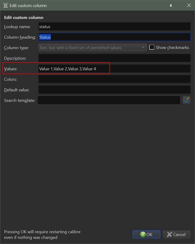

Oops, Add your own columns is a top level item in Preferences.
Name:	Screenshot 2025-09-26 075709.jpg

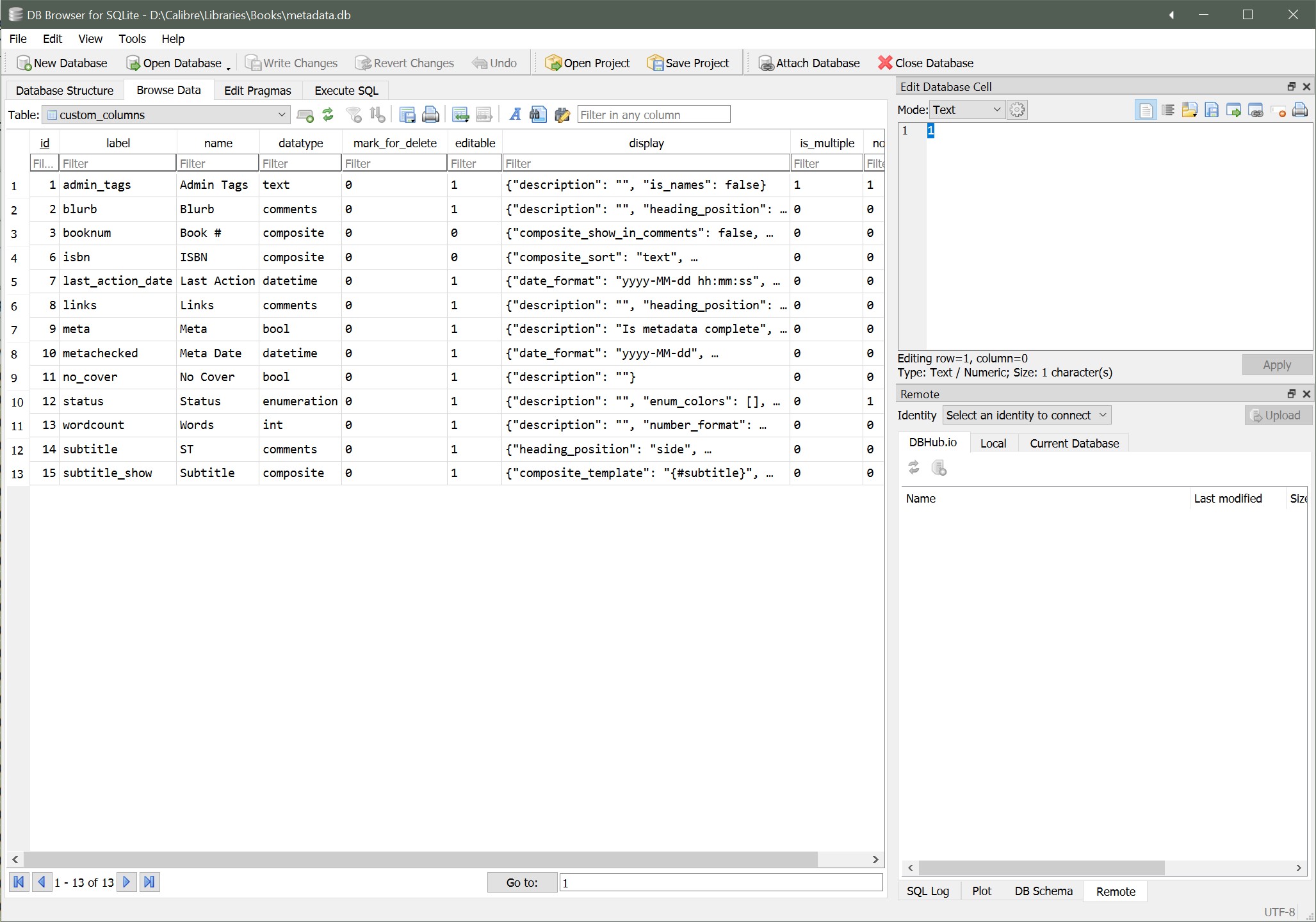

Custom column definitions and values are stored in the metadata database (metadata.db), they cannot be edited directly.
The definitions are stored in a table called custom_columns
Name:	custom columns.jpg
The values are stored in 'custom_column_n' tables, where 'n' is the row-id in the custom_columns tables
Name:	database structure.jpg
Tag like columns such as your "finished" column would also have a 'books_custom_column_n_links' table to associate specific tag like values to specific books.
You add new values to a tag-like custom column by entering it in a book's metadata, once you've done that for one book, you can apply it to other books.
