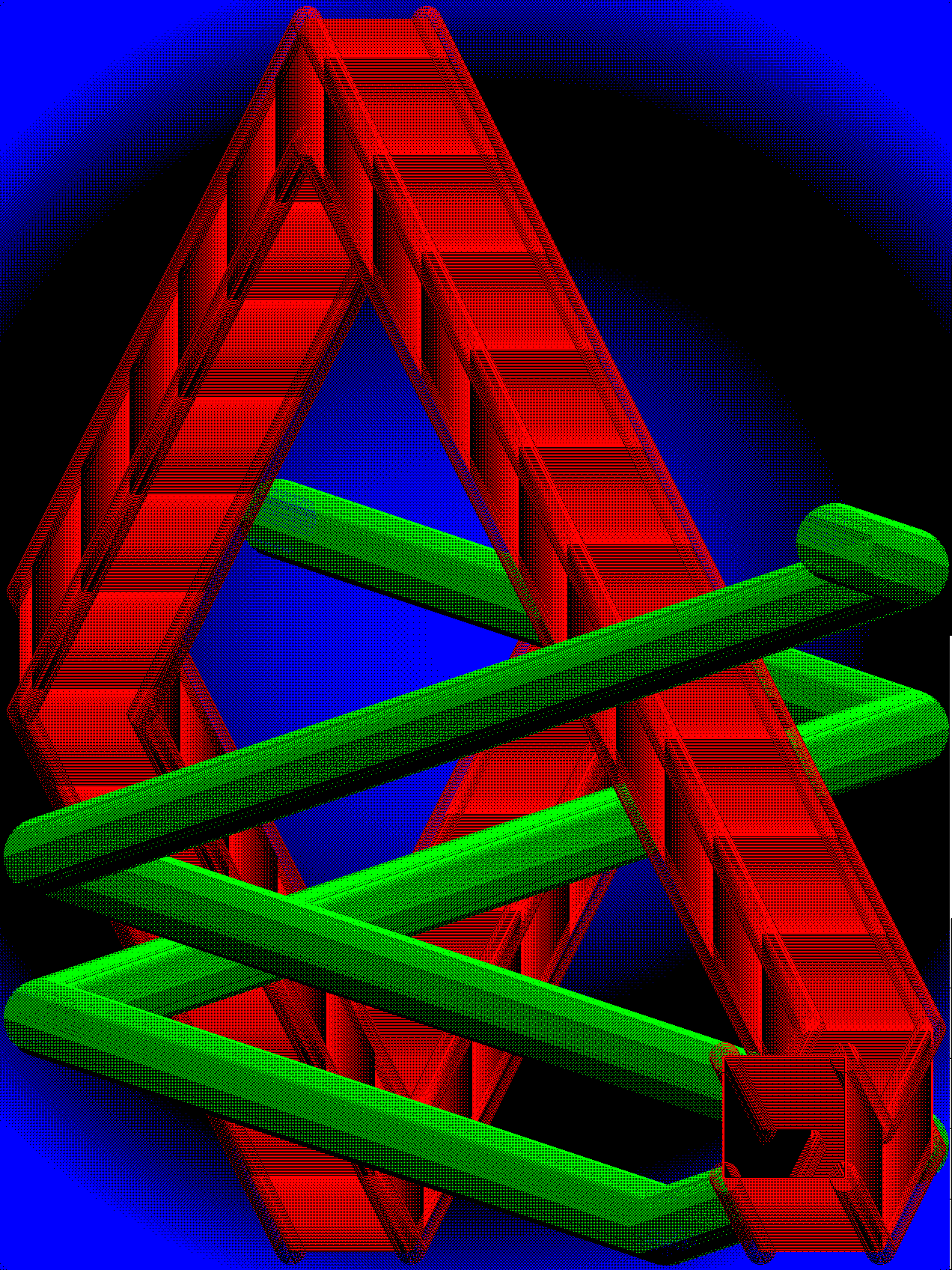

Okay, sorted through all the issues. Attached is a release of the TCC program that runs on Kindles with hard float. This was built from the open source TCC mob branch and assembled with other contents and sometimes with changes as described below.

5) Watch the kindle draw square and round tubes on its eink screen.

7) demo - executable demo program of dithermatron (screenshot from colorsoft attached)

5) demo.c - Now also does color! Randomly selects background, box, and ball to be red, green, or blue. Although they have a random color, they'll never share a color. See screenshot attached at the bottom.
