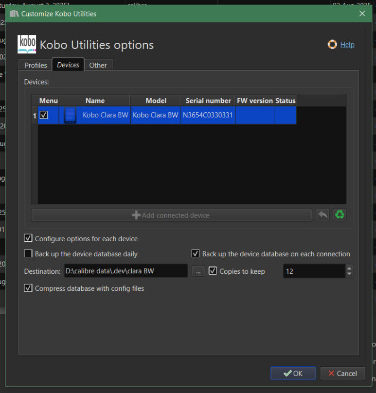

Old 08-02-2025, 02:55 PM   #383
Lavender
Lavender ought to be getting tired of karma fortunes by now.Lavender ought to be getting tired of karma fortunes by now.Lavender ought to be getting tired of karma fortunes by now.Lavender ought to be getting tired of karma fortunes by now.Lavender ought to be getting tired of karma fortunes by now.Lavender ought to be getting tired of karma fortunes by now.Lavender ought to be getting tired of karma fortunes by now.Lavender ought to be getting tired of karma fortunes by now.Lavender ought to be getting tired of karma fortunes by now.Lavender ought to be getting tired of karma fortunes by now.Lavender ought to be getting tired of karma fortunes by now.
Lavender's Avatar
Posts: 97
Karma: 514138
Join Date: Jan 2025
Device: Kobo Clara BW
Originally Posted by Majutsushi View Post
I couldn't find any discussion about why this behaviour of changing the on-device name was introduced in the first place, so maybe no one even knows it exists. Because of this and the above complications I'm tending towards not updating the on-device file and keeping the renaming purely to the KU settings (which would then also allow renaming non-connected devices), but I wanted to first get an understanding of whether people have been using this at all.
Are we talking about this device name?

Old 08-02-2025, 11:53 PM   #384
Majutsushi
Majutsushi is a marvel to beholdMajutsushi is a marvel to beholdMajutsushi is a marvel to beholdMajutsushi is a marvel to beholdMajutsushi is a marvel to beholdMajutsushi is a marvel to beholdMajutsushi is a marvel to beholdMajutsushi is a marvel to beholdMajutsushi is a marvel to beholdMajutsushi is a marvel to beholdMajutsushi is a marvel to behold
Majutsushi's Avatar
Posts: 135
Karma: 11778
Join Date: Aug 2023
Location: New Zealand
Device: Kobo Clara HD, Kobo Libra Colour
Yes the one in the "Name" column, sorry if that was unclear.
