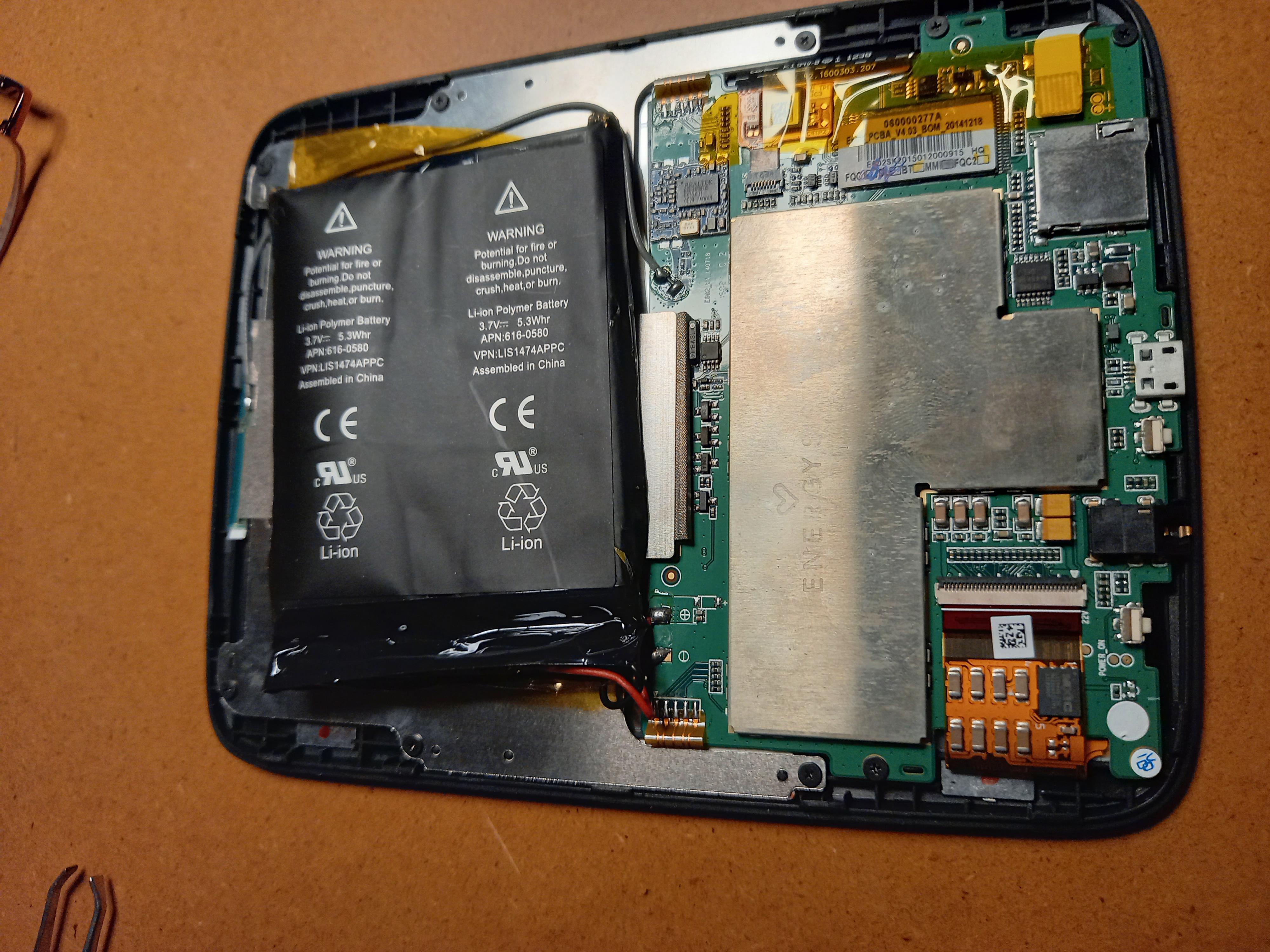

Many ereaders and other things (cameras, phones, tablets etc) that have USB charger won't start at all without a suitable battery.
Some use serial data from a management unit in the cell pack and they won't work with the wrong model of cell (battery) or a bench power supply or via USB at all if there is no compatible battery. Some others have a temperature sensor and some have the serial data and a temperature sensor.
This is the battery the e-book had when I received it.
A curious combination of two modules, APN 616-0581.

I would get that (bulging) battery out of any structure.
Are those 2 packs wired in series? 7.4V (a bit odd, if tru)
No, they are in parallel.
3.7v 2800mAh
