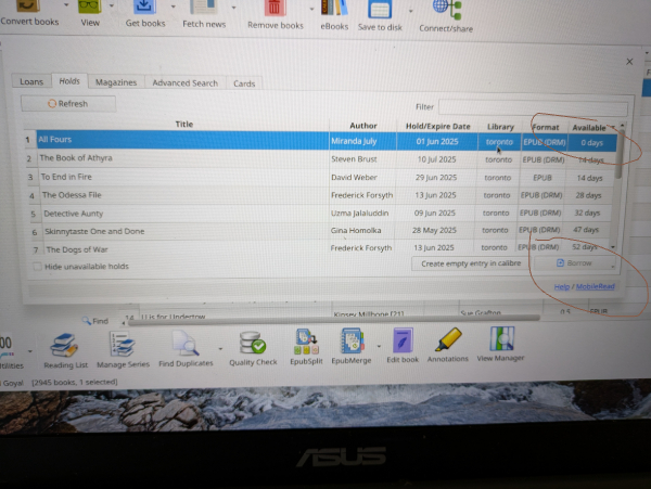

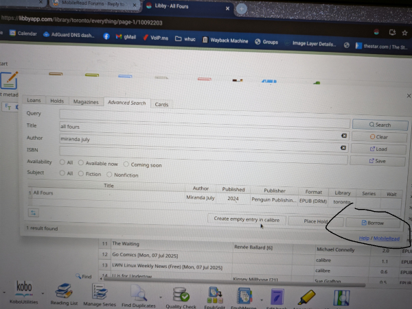

Originally Posted by sgmoore View Post
> Does the plugin support borrowing of a "Skip the Line" book?
I'm not sure. If this is just another name of the 'Lucky Day Copy' then it should be supported.
What happens if you try searching for that book on the advanced search tab? If the borrow button is still disabled there (but enabled on the website) would you mind saving the search results and either upload the json file or send it to me.
OK dokie.. Unfortunately wasn't able to figure out how to screen-capture calibre on a chromebook so had to resort to camera pictures. Noe that in the HOLDS tab the book shows as 0 days, but borrow is greyed out. On the Search tab, borrow is available.
ID:	216848   Click image for larger version

... in the HOLDS tab the book shows as 0 days, but borrow is greyed out. On the Search tab, borrow is available.
Can you try the version at https://github.com/sgmoore/libby-cal...cts/3518302464
sgmoore is offline   Reply With Quote

Ok. Had another loan show up today. Onyx Storm. While yes, the Borrow button was available, clicking it resulted in
calibre, version 8.6.0
ERROR: Unhandled exception: <b>ClientBadRequestError</b>: Failed to borrow book<p>This title is no longer available. You may be able to place it on hold, or add it to your wish list and borrow it later. [errorcode: TitleNoLongerAvailable]</p>

Ok. Had another loan show up today. Onyx Storm. While yes, the Borrow button was available, clicking it resulted in ...
If you refresh the details of the holds - is the borrow button still enabled and if so, does the same error occur when you click it?
The search results shows that your library has 150 copies of this book, but only 1 copy was available at the time of the search. So the only explanation I can think is that someone else borrowed the book after you performed the search but before you tried to borrow the book.

A refresh shows the book as still available.
A borrow from the search menu works correctly.
