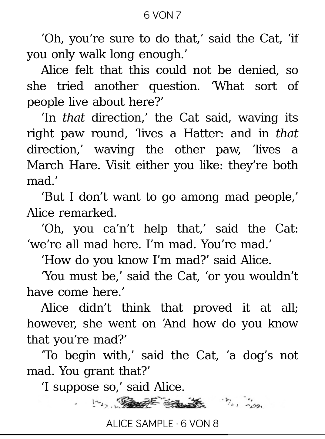

One final data point for which I'll try for images tomorrow. Adding the book to the Kobo Android app does result in the text being wrapped correctly in the L shaped image.
It would be fascinating to see this test done on a Tolino device.
Here you go, screenshots from my Shine 5
ID:	216313   Click image for larger version
ID:	216314   Click image for larger version
ID:	216315   Click image for larger version

I'm going to disagree with you. It does work in calibre's viewer. I am running Windows 11. I think it's something on your end (IMHO). This is screen grab of the ePub you posted without any changes.

Very nice! Just I need to make a small adjustment to the L-shaped image; a typical case of a splitted image. Other images will probably also split if you increase the font size. Could you do that and check if any additional images split? It good be great if only the L-Shape image is affected.
