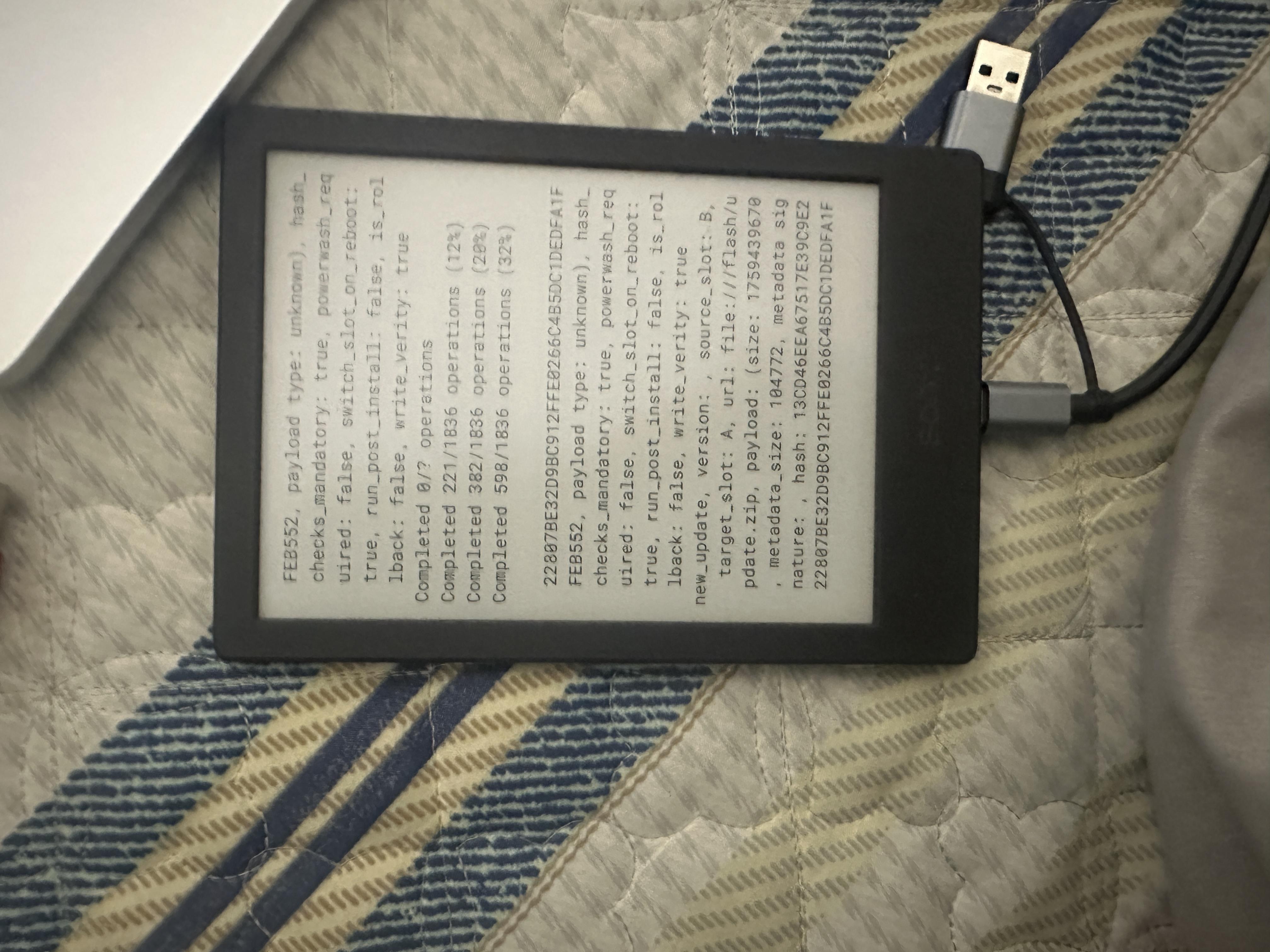

The device has been successfully flashed to the Poke 4 Lite firmware using Renate's custom recovery. Thank you very much for your guidance and support.

Old 06-18-2025, 04:34 PM   #6
flowxd
flowxd began at the beginning.

Thanks for the photo.
I forgot how low-res the Poke4Lite is.
It makes the text look very big.
But at least it got the size and orientation right.

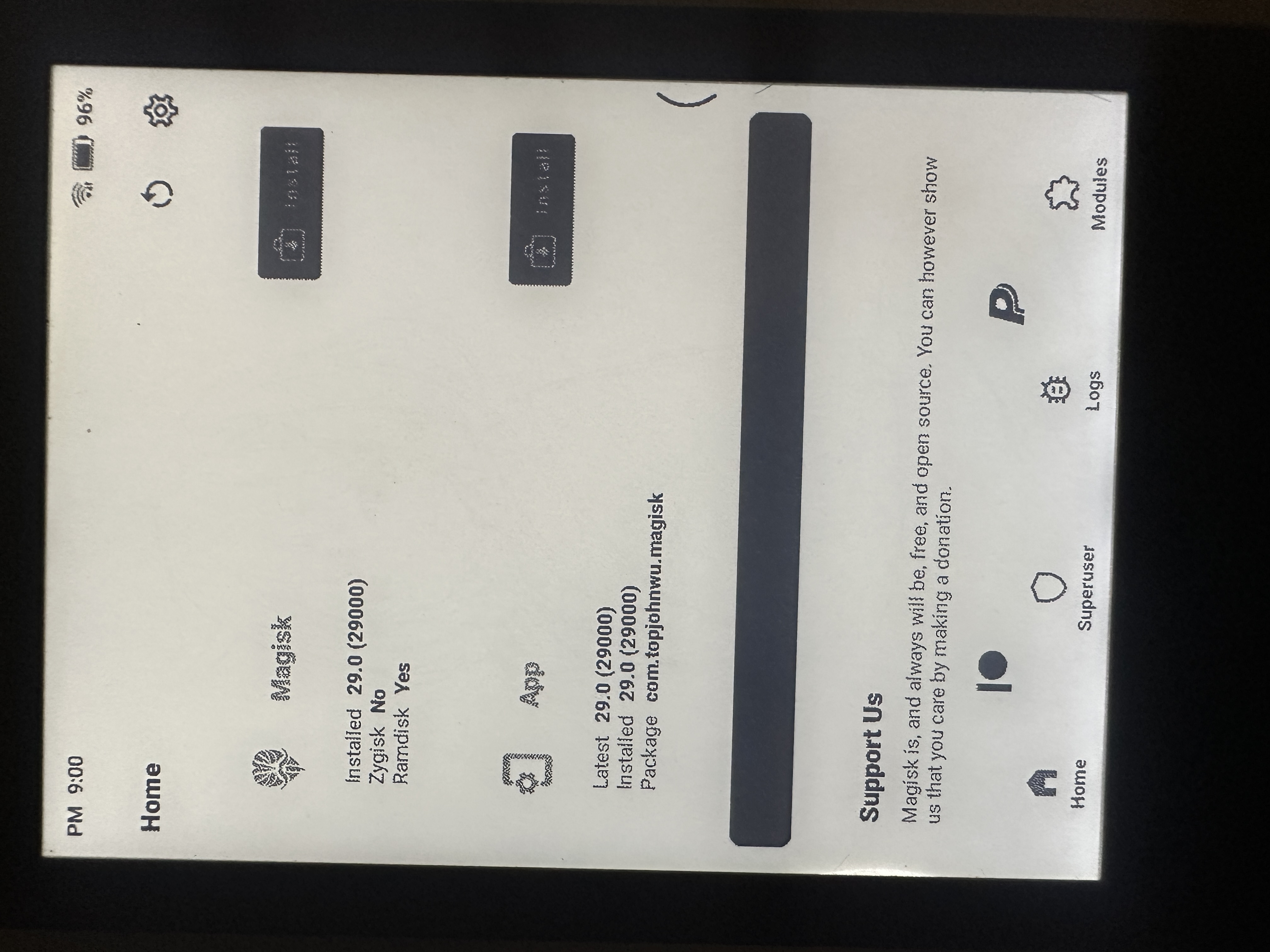

Device: Poke 4S
I successfully rooted the device using an empty vbmeta and a patched Magisk image. However, I want to warn anyone planning to root this device: after flashing vbmeta, the device’s decryption key appears to be lost, and it will prompt a factory reset.

Old 06-19-2025, 12:48 PM   #11
Renate
Onyx-maniac
Posts: 4,157
Karma: 19000001
That's strange.
Did you flash Magisk first and try it without touching vbmeta?
There was no risk of bricking your device.
You should have tried that.
I'm not sure what happened.
What did it say exactly?
