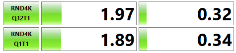

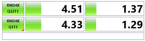

I have. The A2 card actually slowed down my Clara HD. The higher speed might help if I am copying large ebooks to/from since that comes close to the 20 megabytes/second that the 4K video camera the card normally lives in uses. OTOH, when I ran CrystalDiskMark 8.0.6 on the card, the 4K small block read speeds were about 50% of the speed on a Class 6 SD card and the 4K write speeds were 20% of the class 6 card speed. See the attached images for the random 4K block write. Note that the likely cause for a lot of the slowness for the newer cards is that the internal block size of the card is a lot higher than 4K in the 256K to 512K size. For a 256K block size means that writing a single 4K random block results in reading a 256K block, inserting the 4K block and then re-writing the 256K block.
I've attached images of the 2 cards random 4K block writes. I do miss the sequential and random that the older CrystalDiskMark did but I can see why they removed the sequential since that ended in collecting 4K blocks and writing them in one pass.

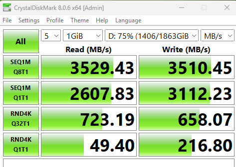

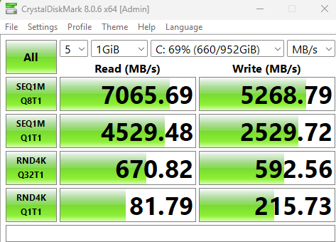

Edit: Just for the heck of it, I attached the results for my two SSDs.
