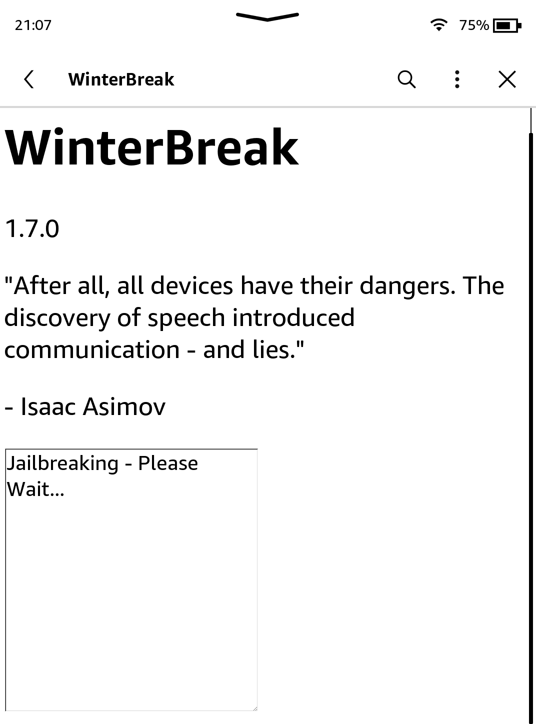

My jailbreak attempt on 3rd May 2025.
Kindle Model - Paperwhite 10th Generation
Firmware version - Kindle 5.16.3
I am following the Winterbreak guide on the Kindle Modding Wiki.
I downloaded the latest Winterbreak release from the website.
Put kindle in airplane mode.
Restarted the kindle.
Copied all the files and folders including the .active_content_sandbox folder.
Clicked on the Store icon, turned off the airplane mode after the prompt.
Automatically connected to an active internet connection.
The Mesquito Launcher opened successfully.
Clicked on the WinterBreak icon.
I can see the first line as follows when WinterBreak attempts to jailbreak,
**** WinterBreak JAILBREAK ****
After this there is no progress even if I leave my kindle for around 10 minutes.
Fearing the automatic updates, I do not let the internet connection run for over 10 minutes.
I have done this 7 times.
Am I missing something?
I have attached the screenshots of the WinterBreak Jailbreaking process (7th attempt).
On my fifth attempt I tried to install the hotfix anyways thinking that the jailbreak was successful, but there was an error and I had to reboot the device.
Do I have to manually update the device to 5.17 and try again?
Or should I try to do this process some more times as suggested on some reddit threads.
After the 6th attempt I removed the temp update file that was downloaded and filled the internal storage leaving only 17MB of free internal storage to prevent download of automatic updates.
Even then there was no progress.
Can someone guide me as to what should be my next step.

I have a Kindle Paperwhite (10th Generation) - PW4 with 5.16.3 firmware on it and I too was only getting **** WinterBreak JAILBREAK **** and nothing else when running WinterBreak. Since both of you had the same output as each other and both have 5.16.3, I assumed there is an issue with 5.16.3. I noticed others in this thread having newer firmware so I sought after finding a way to download the 5.17.1.0.3 firmware from Amazon and I did figure it out. After factory resetting and signing in and visiting the Kindle store and clicking on a book on 5.16.3, I put it in airplane mode and manually upgraded to 5.17.1.0.3 and then rebooted and then factory reset and logged back in and visited the kindle store and clicked on a book and put in airplane mode. Not sure if all those steps were necessary but I was trying to make sure everything that could be done was done. I retried WinterBreak and it completed and I was able to go through the rest of the steps and now have KOReader installed. The hotfix did give an error getting back to the gui but I just hit ok and kept moving through the process once back to the main screen. Also during the KOReader install from the scriptlet, the screen stayed white for a long time, but did eventually complete. Below are the links to the Amazon servers for 5.17.1.0.3 firmware for both the Kindle (10th Generation) - KT4 and the Kindle Paperwhite (10th Generation) - PW4. It may be possible to download other versions by changing the version numbers in the url if you know a different valid version number, but I'm not sure as I only tried 5.17.1.0.3 out. That's how I figured out these url's is by starting to download the 5.18.1 firmwares and then stopping it and then checking my browser history and then bookmarking it and then editing the bookmark to copy the url and then modifying the version number. You can goto Amazons Kindle download page and try it yourself to be sure. Also maybe the devs will eventually figure out what the issue is with 5.16.3 and fix it in a new version of WinterBreak so you can stay on 5.16.3. If you don't mind upgrading though, this might work for you. Thank You to the developers for making all this possible!
Make sure you download the right one for your device. Use at your own risk!
update_kindle_10th_5.17.1.0.3.bin
update_kindle_all_new_paperwhite_v2_5.17.1.0.3.bin
