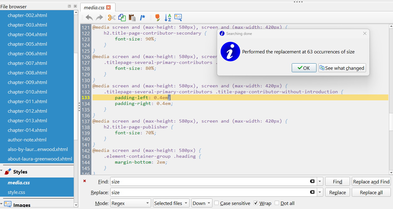

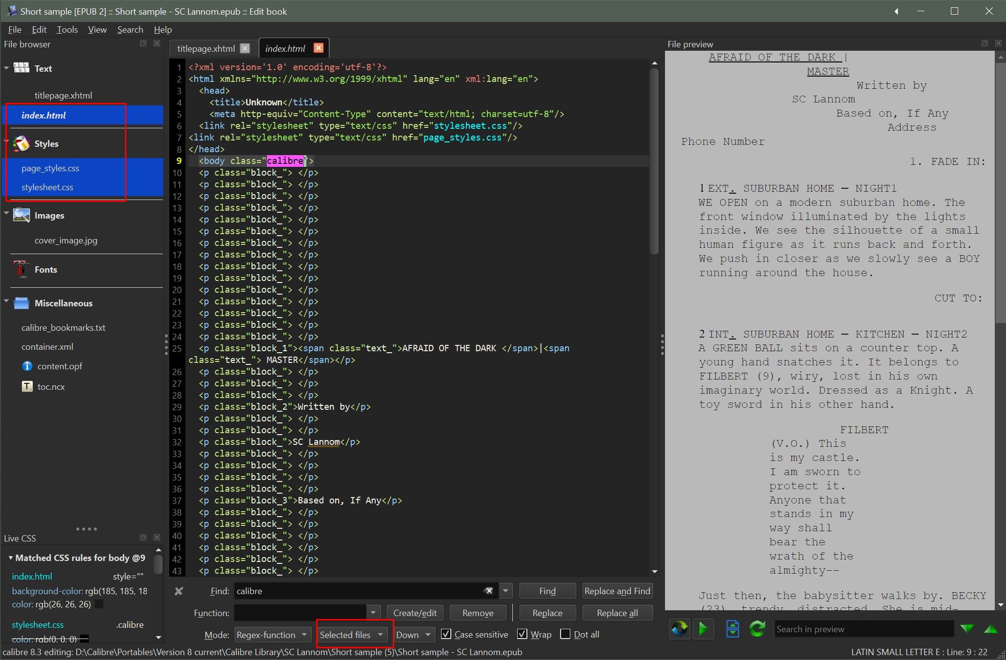

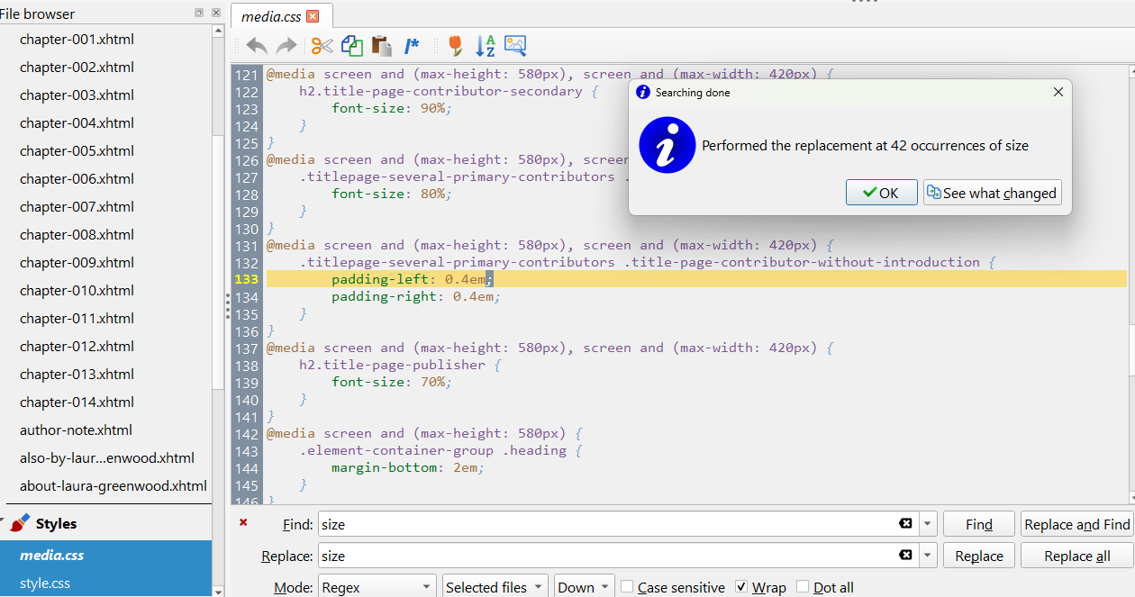

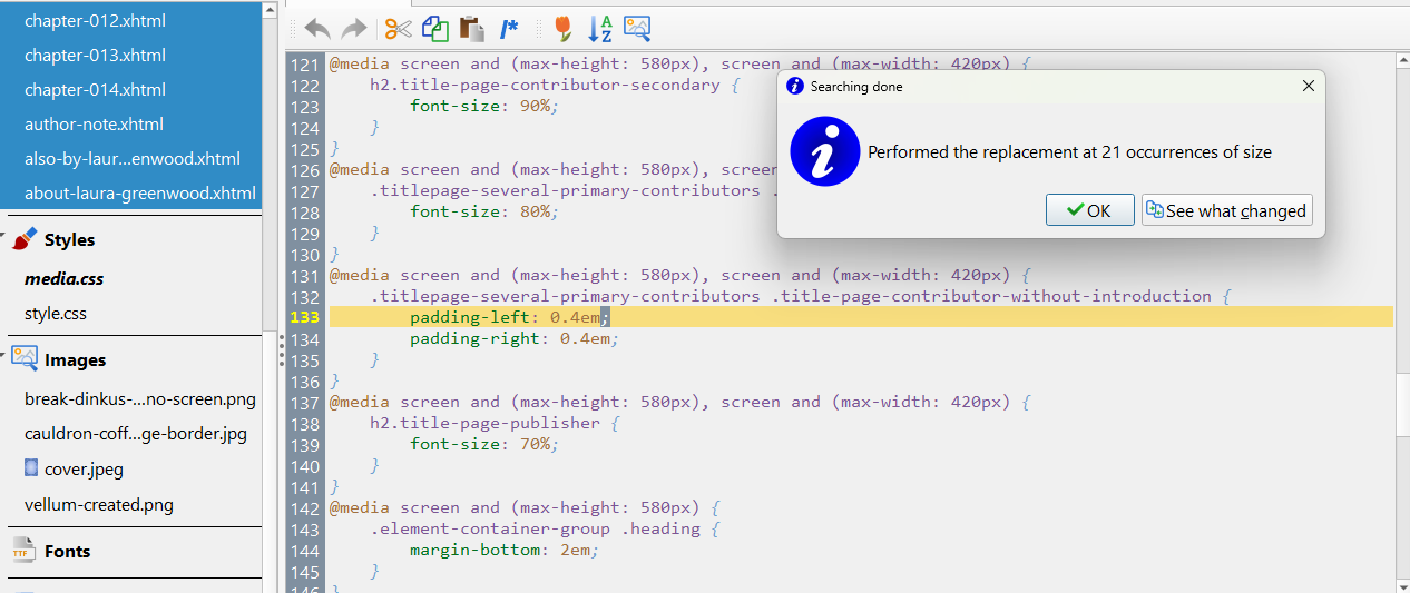

You can try a work around by selecting all the text and style files in the file browser and Selected files in the dropdown. See images for results. Again, I do not recommend doing this especially if you are using regex. As the images show, size is found 21 times in the text files, 42 times in the CSS files and 63 times in the combined text/CSS files.
