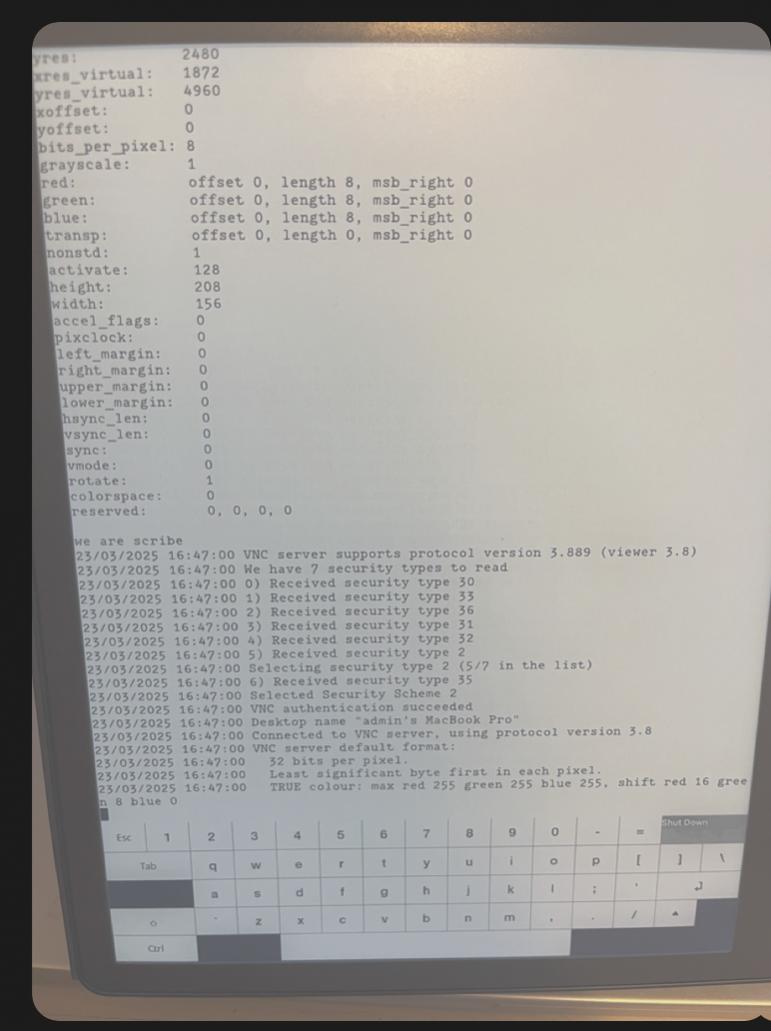

It says it's connected (I am using the native Screen Sharing on my Macbook) but it doesn't show the actual screen it seems, just stays in the kterm terminal (see attached screenshot), am I supposed to do anything else after the ./luajit vncviewer command?
I think it's because kterm is a graphical app which window takes whole of the screen and most likely it has "priority of -1" so you won't see anything overlayed on top of it.
My tests were done by running kvncviewer via terminal ssh into scribe.

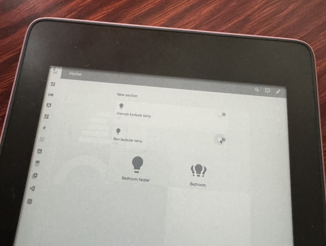

I got this working on armhf on a kindle PW4 running 5.16.3. Cross compilation was a righteous PITA and i stumbled numerous times.
Made some changes to vncviewer.lua and also did some experimentation with vncviewer_smooth.lua to try and increase the rectangle sizes which are abysmal on anything with animation. It's enough for a loose experiment with Homeassistant but i'm probably inclined to go back to non-interactive mode.
There was also a bunch of hacking i had to do with eips to get the screen to refresh properly.
A bit more tweaking and you'd probably be golden, but frankly i'm out of steam.
