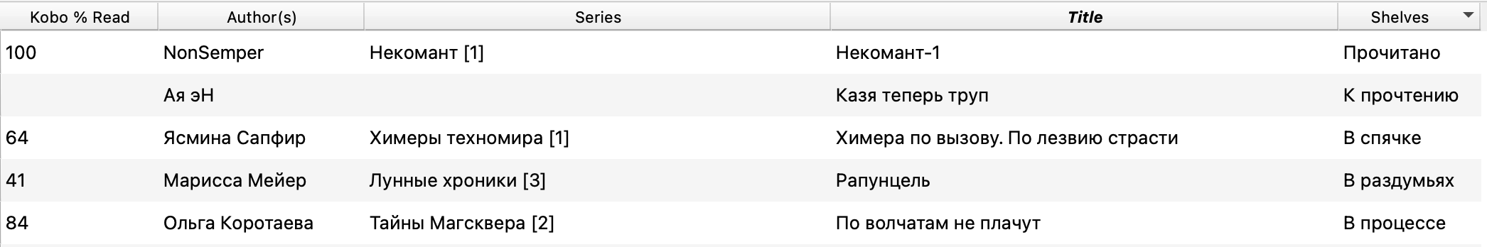

The last year and even a couple of weeks ago I had my Kobo synchronized with my MacBook Pro M2 by means of Calibre (updated to latest version 8.0.1) with Kobo Utilities plugin (updated to latest version 2.20.0) and SmartEject plugin (updated to latest version 2.6.0).
But yesterday that very Calibre on my MacBook stopped to launch synchronization upon connection with my Kobo (Calibre just didn't react on USB cable connection, though MacBook saw my Kobo device and Kobo properly switched to 'Connection' status).
So I made DB export from Calibre and created a catalog of the books prior to Kobo factory reset.
Then I made Kobo factory reset and no reaction again from Calibre: no sync...
I restarted MacBook and Calibre woke up (it seems that instead of Kobo factory reset I just had to restart MacBook, but what done is done).
Now all my 414 books from Calibre DB (including tittles, series, authors) were synchronized successfully with Kobo BUT
All of the books on my Kobo are now 'unread' (instead of particular 'Kobo % read' column old values in Calibre) and all of the books on Kobo are not sorted through (though I see all my 5 old shelves in Calibre).
1. Can I restore on my Kobo previous 'unread / reading / finished' statuses, which are still visible in Calibre?
2. Can I restore former reading positions that I still see in Calibre?
If not, - what actions / settings should I make to reset in Calibre values of (i) 'Kobo Reading Location' and (ii) 'Kobo % Read' columns and to start synchronization of both attributes mentioned above from the very beginning.

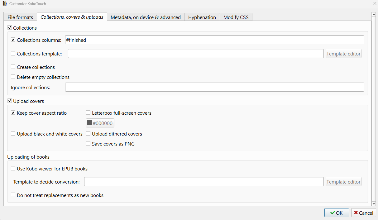

Ooo! Never heard it can work this way also. All the time from every Kobo user I have heard that Collections can be created on Kobo only so that they could be mirrored in Calibre after this.
Is 'Kobo driver' a plugin to Calibre? - Maybe 'Kobo Touch Extended'?
- But Kobo touch extended drivers are now removed by calibre 8 and can no longer be installed.
- Or it's Calibre built-in feature?
Will you please post appropriate settings screenshot?

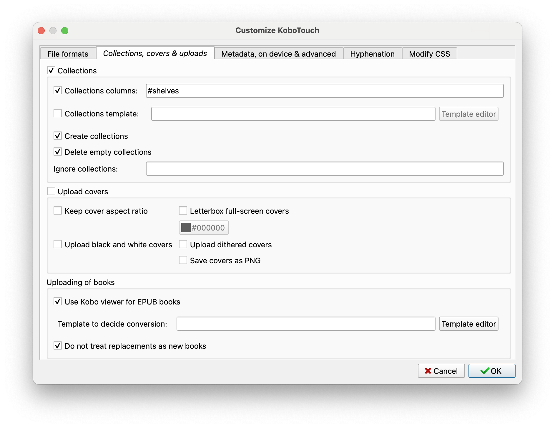

Old 03-23-2025, 02:17 AM   #8
Sirtel
Sirtel's Avatar
Posts: 15,993
Karma: 251114109
Join Date: Jan 2014
Location: Estonia
Device: Kobo Sage & Libra 2
Kobo driver is built-in. I've added screenshots.

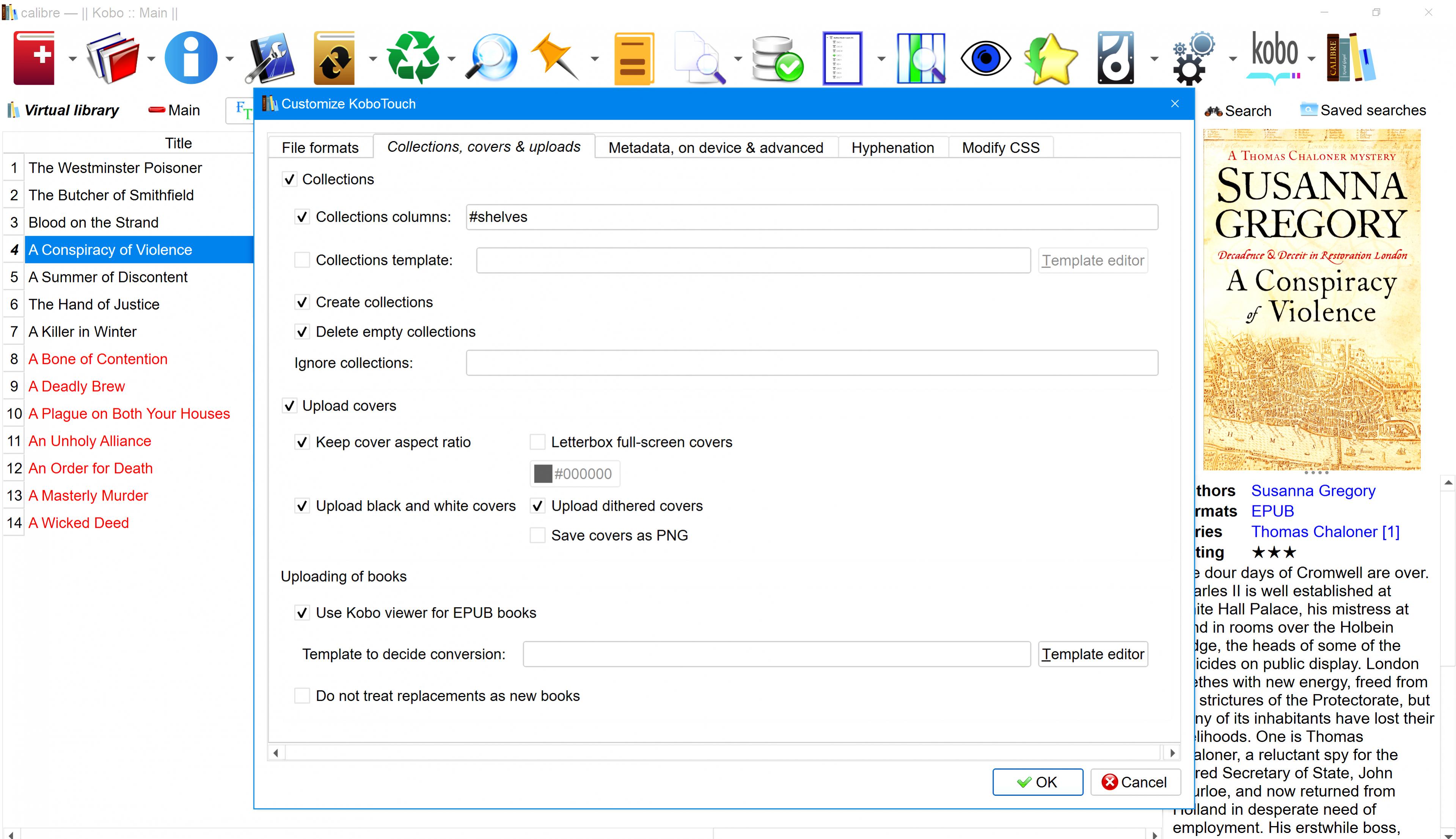

Old 03-23-2025, 02:19 AM   #9
Posts: 56,060
Karma: 182882152
The KoboTouch driver has been built into calibre for what seems like forever. It is used by many to create collections on a Kobo based on whatever criteria you can fit into it's collection columns or generate from it's template. As for the KoboTouchExtended driver, it's main difference from the KoboTouch driver was the ability to convert an ePub into a Kepub on the fly. It's collection setup was identical to the KoboTouch driver. With the KoboTouch driver in calibre 8.0 gaining the ability to do that on the fly conversion, the KTE driver is no longer necessary and will not run in calibre 8.
As for me, I use the Kobo Utilities Update Metadata and Store/Restore Current Bookmark and their custom columns to save reading statistics and to restore them after a factory reset. My collections are limited to a single one called Finished just to make it easier when I feel like removing finished books from my Kobo's.
Name:	Screenshot 2025-03-22 221037.png

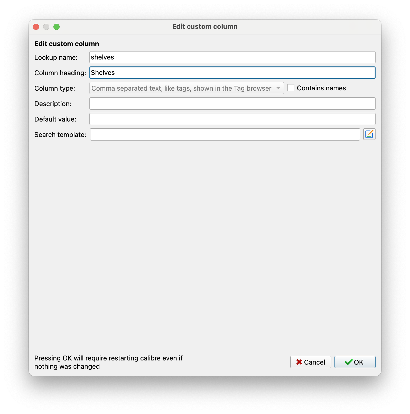

Thank you. - I have (and need) five Collections through all my eReaders (including Kobo). - How can I reserve more than one Collection in Calibre settings?
You create a custom column with those five values and enter the column name in the driver settings. For example, I have genre-based collections - mystery, science fiction, fantasy and so on. They're all values in my #shelves column, which is the base of my Kobo collections. I enter the relevant values (i.e. genres) for individual books while editing metadata in Calibre, and the column name (shelves) in the driver settings.
will you do me a favour and post here screen of this very column settings please?

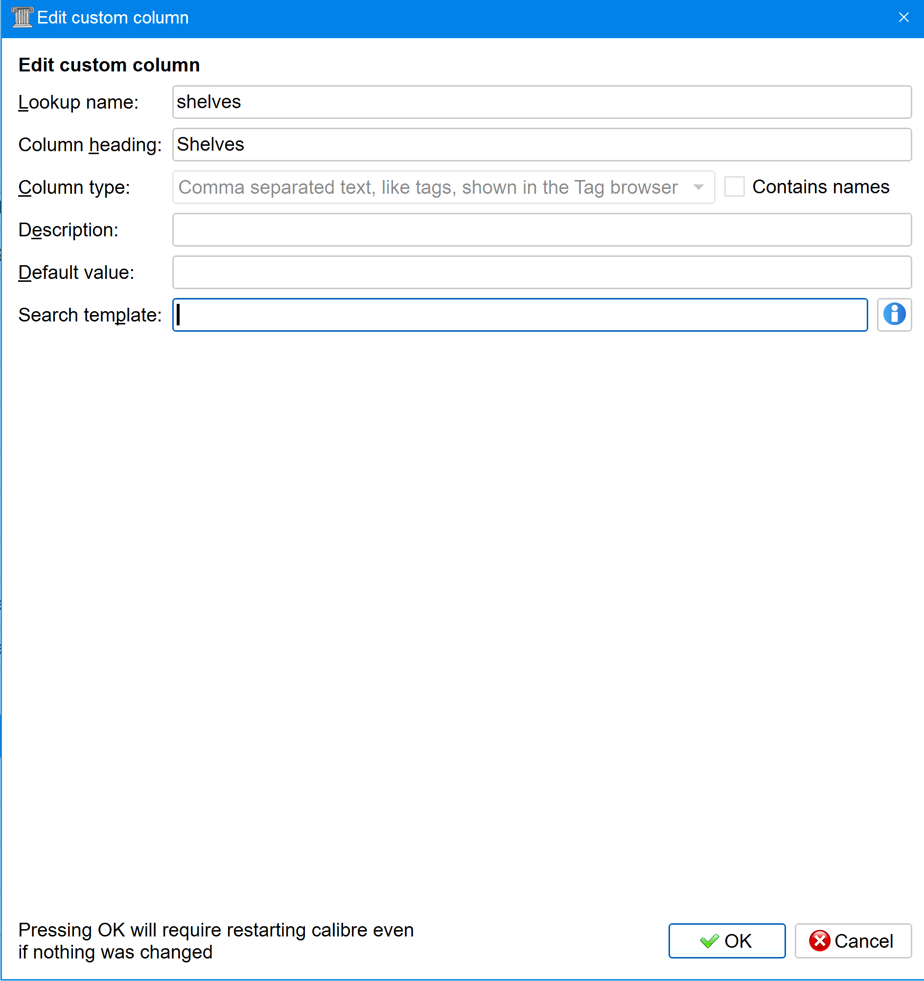

Old 03-23-2025, 07:46 PM   #13
Sirtel
Sirtel's Avatar
Posts: 15,993
Karma: 251114109
Join Date: Jan 2014
Location: Estonia
Yes, but there's not that much to show; it's a very simple column, really. Yours could be something completely different, depends on what you want. For me, it's just a handful of genres and a couple of other keywords. I haven't bothered with complex templates or anything like that.
Name:	24-03-2025 00-41-15.png
ID:	214614   Click image for larger version
Name:	24-03-2025 01-01-28.jpg

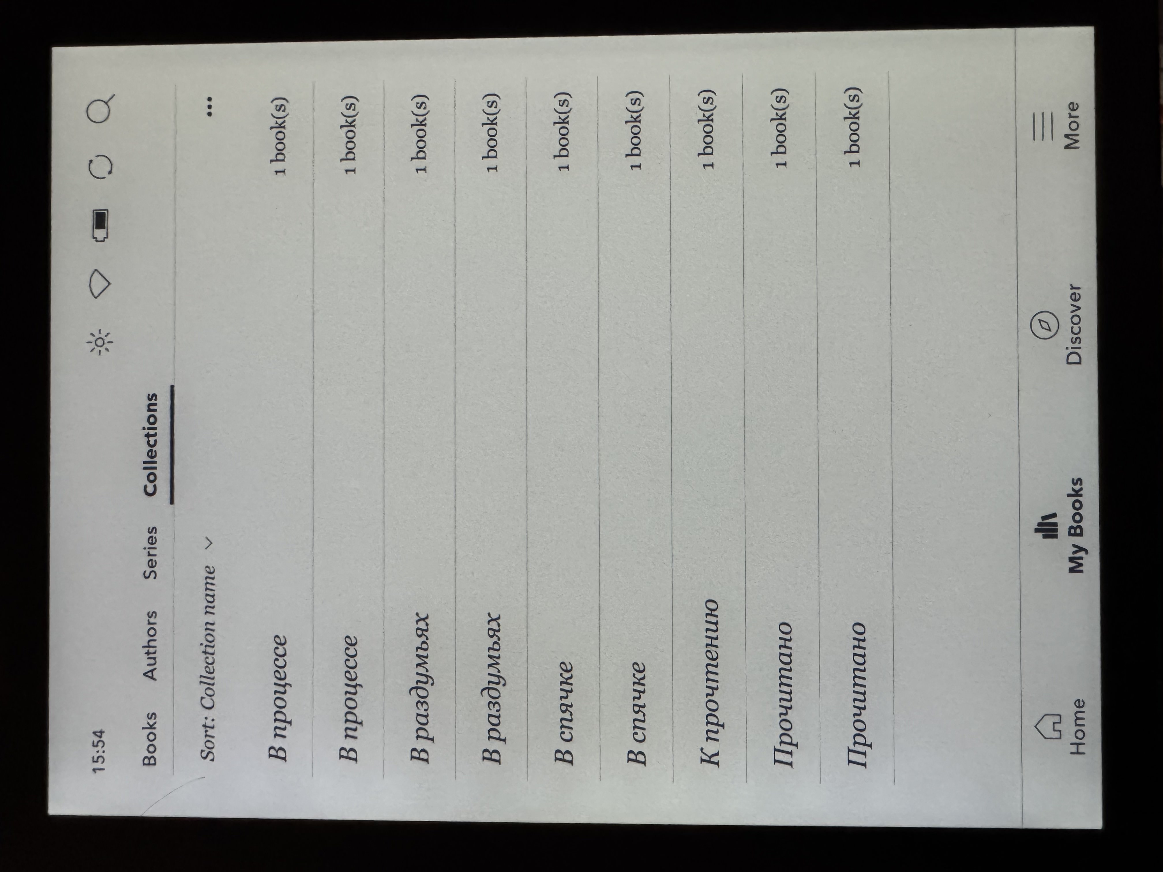

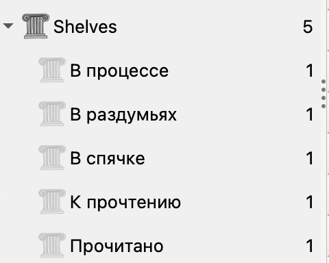

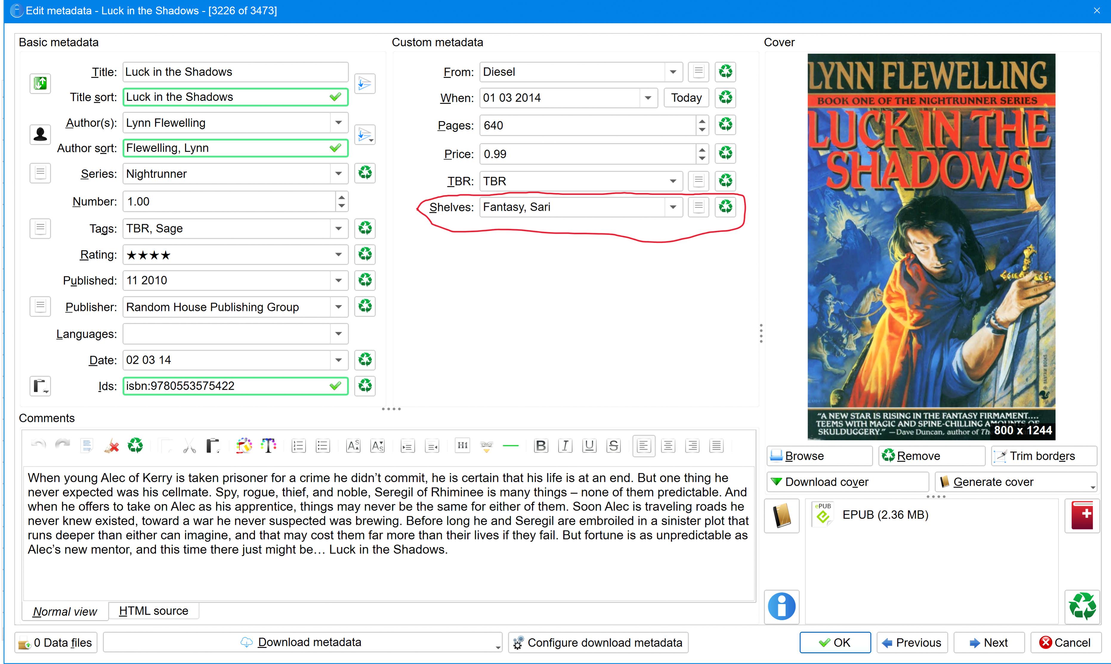

Old 03-24-2025, 10:11 AM   #14
baursak
baursak began at the beginning.
Posts: 104
Join Date: Mar 2024
Location: Saint Petersburg, Russia
Device: Kindle Paperwhite (2021) Signature Edition
1. I set KoboTouch driver
2. I add a custom column
3. I mark 5 books with 5 different values and sync with Kobo
4. I get 5 Collections in Calibre
5. I get 9 (2+2+2+2+1) Collections on Kobo
So, it didn't work on my side, alas
ID:	214622   Click image for larger version
ID:	214623   Click image for larger version
ID:	214624   Click image for larger version
ID:	214625   Click image for larger version
baursak is offline   Reply With Quote
