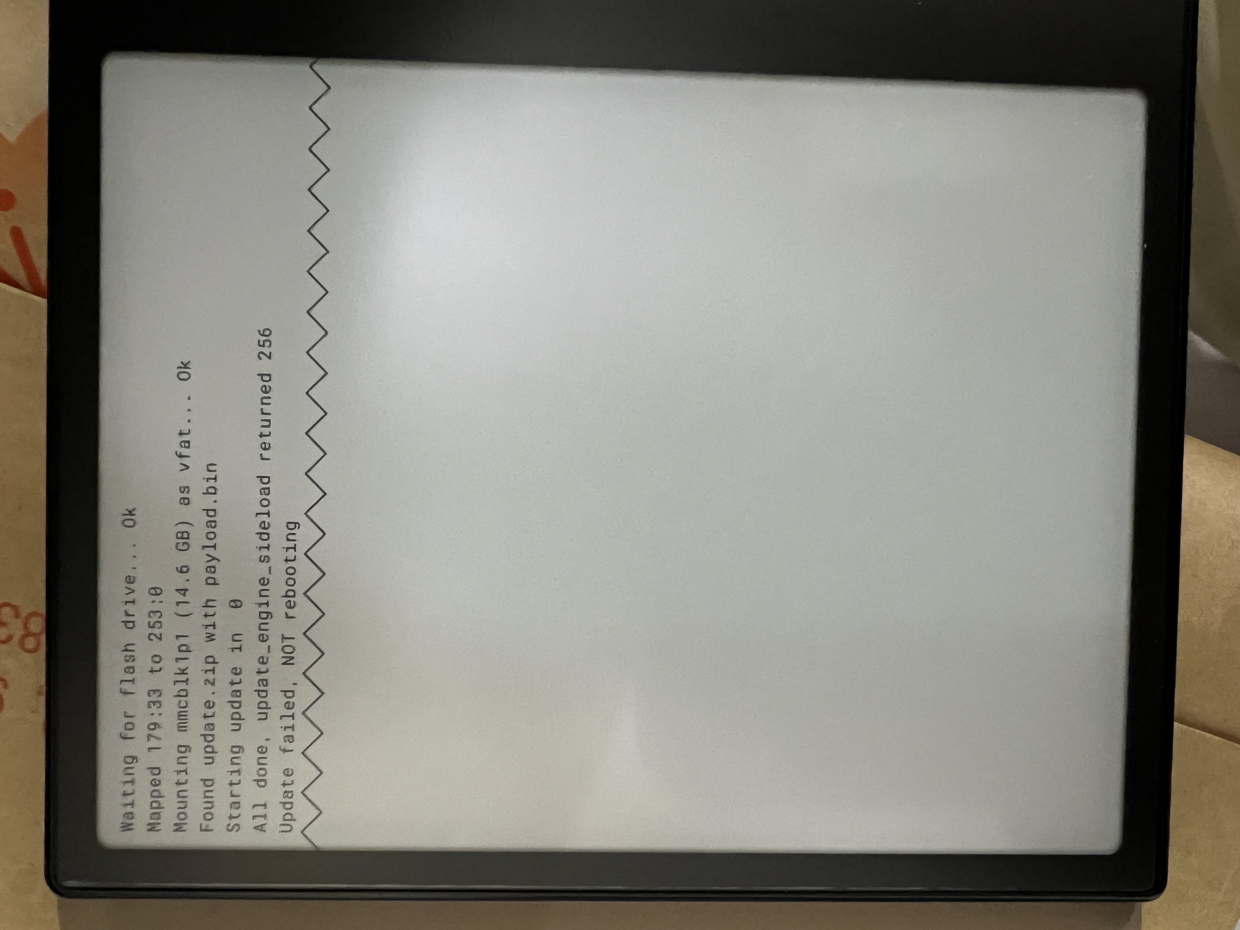

Hi Renate,
Update failed as the image I attach, please help me check.
Thank you.

Here is the update logs.

Edit: I am leaving this here for historical accuracy.
I hope that things are fixed now (May 2025).
Do not issue any commands that have anything to do with "bootdevice".
Originally Posted by Old procedure
Ok, reboot fresh, then
adb shell
# ln -s /dev/block /dev/block/bootdevice
# ls -l /dev/block/bootdevice/by-name
Does it print lots of stuff (including "misc")? Then proceed. You don't need (to explicitly start) ttyscreen.
# start autoupdate
Same procedure as last time.
Renate is online now   Reply With Quote

Hi Renate,
The device has been updated successfully, It was change to Boox Page with the English and Vietnamese library. Thank you very much for your support. I will note your guide as a tutorial.
Thank you.
