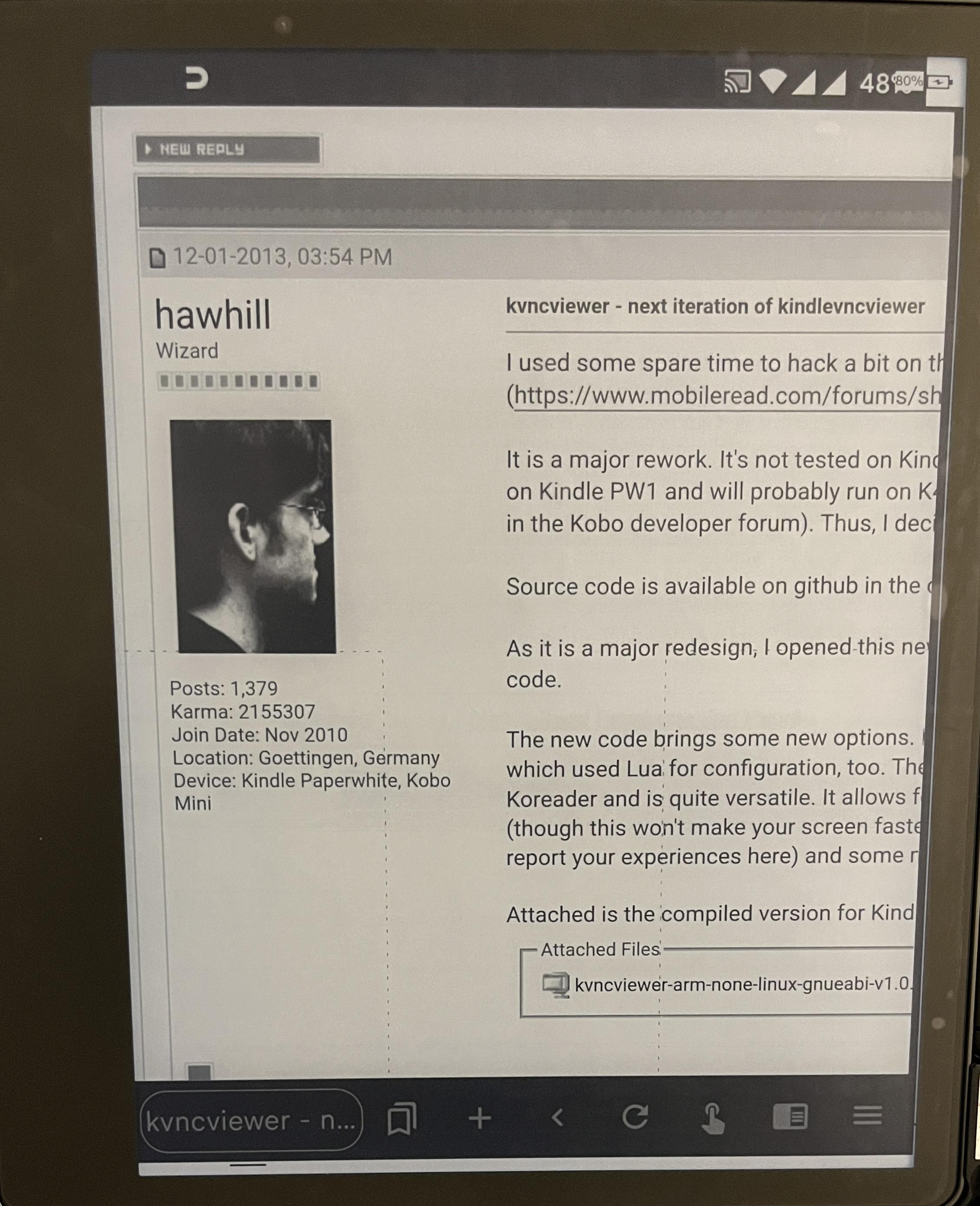

Just sharing a working version tested on 5.16.2.0.1 for others. I am able to use my Android mobile screen(Apps like Eink Bro Browser(created for android e-ink readers),chrome are looking good on kindle screen).
Changes in the attachment:
1. Recent bug fix from Github(key-event) bleeding, fixes an issue where VNC touch events were getting propagated to kindle gui
2. couple of fixes from older responses in this thread, missing constants
3. recent fixes for newer versions of PW, to refresh the screen in an infinite loop
4. Working touch control
Usage:
1. Adjusting the screen resolution of android phone(will be acting as VNC server) to match the Kindle resolution
Log into Android shell using adb connect & use the below command:
wm size 1836x2448 :Kindle Scribe Resolution(need to be adjusted as per kindle model)
wm size reset :Should be executed, when mobile phone should be reset to it's original resolution
There are some applications available in play store, to adjust mobile screen resolution with out using adb tools on laptop.
2. I am starting VNC server on my mobile with application https://github.com/bk138/droidVNC-NG
3. Now I have a VNC server, which is providing the content in the resolution of kindle. Replace the IP address and Port from your VNC server(android) in the file: kvncviewer.sh
./luajit vncviewer.lua 192.168.23.12:5900
4. If any password is set in the VNC server, provide the same in the file:vncviewer.lua. Replace nil with "<yourpassword>" (including the quotes)
5. Lauch the vnc viewer from KUAL
How to exit from vnc viewer:
Option 1: Force Restarting the kindle(easiest option). Even when the VNC server is stopped on mobile, it is recommended to restart the kindle immediately, after using it as VNC viewer
Option 2: If you can do SSH into kindle, find out the parent PID of the kvncviewer.sh process from htop and kill the same using pkill -P $parent_pid
Screenshot:
Viewer:
kvncviewer.zip
I would like to thank all the developers(creators) for their contributions and making our devices more productive.
Disclaimer: I am not responsible for any damage to the kindles. I just colated the files from different sources and wanted to share a working version(giving back to community). Setting up vnc viewer requires USB Networking(Wifi mode) working for this use case. If you want to use this application, be ready to be patient(time it takes to get it work for Newbie, is high) and doing your research.
scribe_user is offline   Reply With Quote
Usage:
Screenshot:
Attachment 207917
Viewer:
Attachment 207915

Originally Posted by osse View Post
It compiles without, after building I copied KOReader luajit and it runs however there are few extra steps:
1. Add Scribe fb to be recognized by the script.
Before else, https://github.com/hwhw/kindlevncvie...linux.lua#L175
                        elseif fb.finfo.smem_len == 9285120 then
                                -- We're a Scribe 2022
                                print('we are scribe')
                                fb.wait_for_full_updates = true
                                fb.einkWaitForCompleteFunc = kindle_pearl_mxc_wait_for_update_complete
2. Remove missing? CONSTANT. ¯\_(ツ)_/¯
./luajit: ./ffi/framebuffer_linux.lua:89: missing declaration for symbol 'MXCFB_WAIT_FOR_UPDATE_SUBMISSION'
so I modified to return null here:
https://github.com/hwhw/kindlevncvie..._linux.lua#L87
And got to connect, move window around for 2-3 seconds:
https://imgur.com/yhAUrw2
and then it crashed with another
missing CONSTANT:
./luajit: ./ffi/framebuffer_linux.lua:45: missing declaration for symbol 'MXCFB_WAIT_FOR_UPDATE_COMPLETE_PEARL'
stack traceback:
        [C]: in function '__index'
        ./ffi/framebuffer_linux.lua:45: in function 'einkWaitForCompleteFunc'
        ./ffi/framebuffer_linux.lua:372: in function 'refresh'
        vncviewer.lua:94: in function 'cb'
        ./ffi/eventloop.lua:188: in function 'loop'
        ./ffi/input_kindle.lua:42: in function 'waitForEvent'
        vncviewer.lua:315: in main chunk
        [C]: at 0x00013ea9
I wonder if it wouldn't be easier to re-use KOReader screen management lua's as they've been updated frequently.

Without the logs hard to tell.. but I got some good news.
After modifying the return value for other missing constant to null I got kvnc to work without any other issues. There's no need for usleep loop hack to be ran in parallel either. Simply starting the script is enough for refresh to work fine.
I've tested on Scribe by 'extending' macos screen onto it. The responsiveness on wifi was ok for typing experience, especially given there were 3 hosts at play here. (Kindle kvn client connects to Linux Xvfb running xvnc server with uxplay as X application. Macos extends screen via airplay to uxplay.)
Oh wow that sounds amazing! Are you able to share the code that works with the other constant changed? Would love to give this a try to alleviate some eye issues. I am converting PDFs to EPUB already with Bartik (the only one that seems to be able to do scientific papers) to be able to change font size of things as my eyes are pretty bad, would prefer to use eInk everywhere (wish everyone followed the PDF accessiblity standards but oh well....).
Also playing around with Calibre now but local conversion isn't as good. But if I can Linux fully working on the Scribe that may be an option too to do it locally on the device.
Sure, the entry I removed is https://github.com/hwhw/kindlevncvie..._linux.lua#L45 so this line is just
return
I can prep a zip of my build too.
