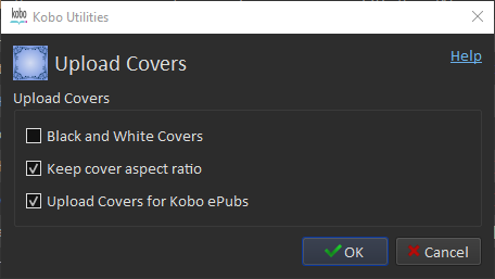

What happened to the upload cover dialog? it looks different and I don't see in the changelog.

I haven't changed anything about uploading covers. What differences are you seeing?

I seem to recall more options like letterboxing.
Name:	2025-03-20 05_29_07-Kobo Utilities.png
Is it difference of the Touch and TouchExtended drivers? Only thing I can think of.
Attachment 214466
You are correct, the old KU has six options (I haven't updated yet, I'm on Calibre 7.24 and Kobo Utilities 2.17.2).
I notice that your screenshot is only showing the options down the left-hand side. Perhaps the size of the window was reduced, and everything else fell off the right-hand side?

Does this mean we lose the dithering for covers?

I checked the code and the additional options are behind a dynamic check for Touch devices that broke recently since the check is not picked up by static analysis. I've fixed it and will create a release soon together with the other changes for Calibre 8.
I'm tempted to drop support for non-Touch devices since the dynamic checks necessary to support them risk causing more such bugs in the future. Is anyone still using these ancient devices?
