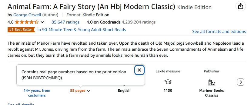

I see nothing about page numbers on that ebook page, or "Contains real page numbers based on the print edition (ISBN B0BTPCMNBQ).
You have to hover your mouse over where it says "55 pages" in order to see it.

ISBN-13 starts 978 0r 979
ISBN (10) can have a check character of X or digit, All the rest are digits.
What you show should be RED in the MDE

ISBNs are purely Numeric
B0BTPCMNBQ looks like an Amazon code and I don't see that either.

Originally Posted by mallomar View Post
That's bizarre. It's definitely not a personal document but a library loan which I pulled off of my Kindle, which I feel okay ripping since I own a hardback copy:
A hardback copy gives zero legal or moral entitlement to the ebook, unless the publisher says so. A very few titles include the ebook. Not that one.
I'll try borrowing it again and seeing if anything changes.
Won't be the first time Amazon has Garbage data on their catalog pages.
It sure would help if the folk who make these pages had a clue about the Products they are responsible for. The might catch that THAT was their ASIN not ISBN
