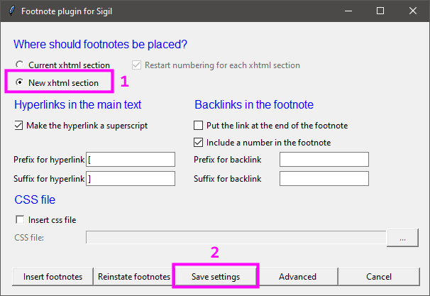

Hi. Great plugin, very useful. So useful for me that I created an account just to ask this question
Is there a way to change option "Where should footnotes be placed" to "New xhtml section" as default (checked radio option)? I use footnotes extensively, but I prefer to keep them in a separate file and often forget to change this parameter.
I tried
self.radioFootNote.set("C")
to
self.radioFootNote.set("N")
but I got nothing.

You don't need to change the code, because this setting is up to you.
1. select “New xhtml section”.
2. press the “Save Settings” button.
Done.

I wonder how I didn't think of that myself. Thanks a lot.
