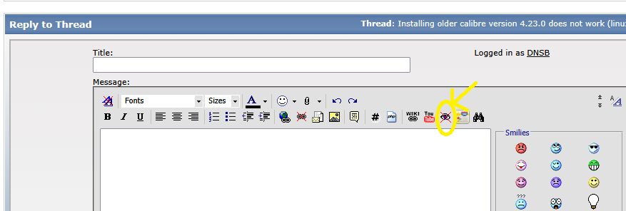

Old 03-06-2025, 07:20 PM   #13
Posts: 48,331
Karma: 174315444
In Advanced mode, you will see a eye with a X between the YouTube and Map icons. Simply enter your text, select it and click on the spoiler icon.
