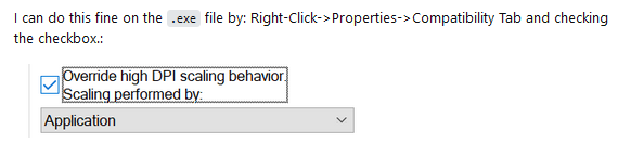

First thing I would try is this Windows setting:
https://superuser.com/questions/1230...e-command-line
Right-Click->Properties->Compatibility Tab and checking the checkbox: Click image for larger version

(as I noted in post #3 of the thread about the env vars)

I did that for the viewer, but it didn't change anything - the text is still fuzzy.
