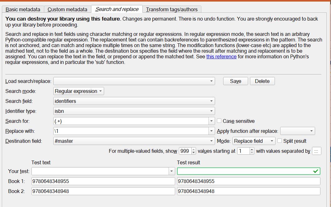

Are yo using Bulk mode S&R in the MDE? That can be used to copy to another column.
My example is the reverse of your task . BACKUP before you try (or use a copy till you get it right )

You might need to replace including a literal part
isbn:\1
The \1 is the captured value from above. isbn: is the literal

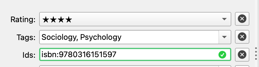

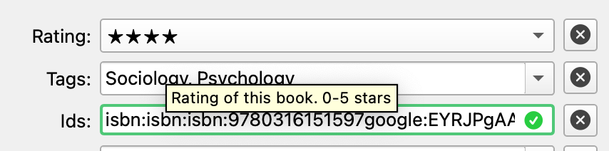

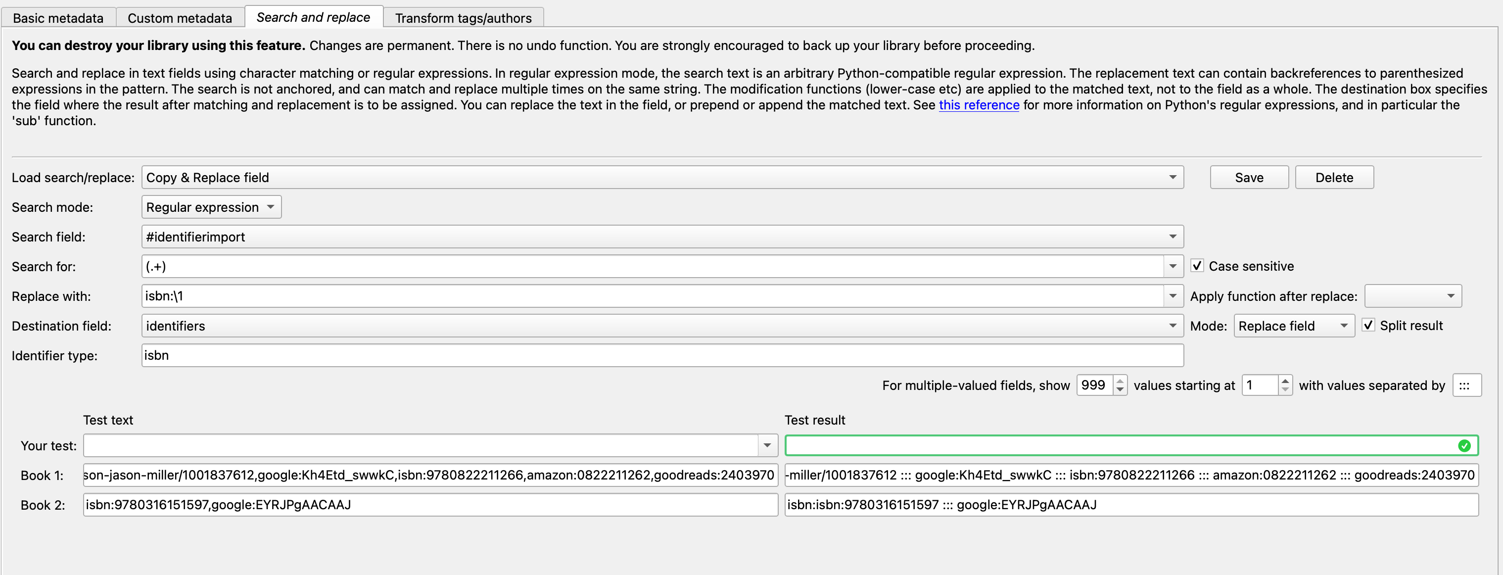

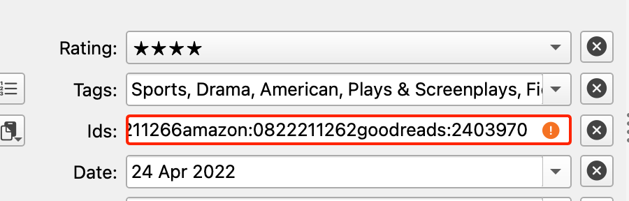

Firstly, thank you very much for coming back to me, i really appreciate the help.
I tried both ways and unfortunately i am not getting the correct result.
I have multiple ID's in the identifier field per book and I am seeing 2 issues.
Firstly, when the copy is made, it is removing the commas separating each value, which renders them useless.
Secondly, with the first REGEX it doesn't bring through the second identifier and with the second REGEX it brings them through (again with no commas) but also adds extra isbn: prefix to the string.
I have attached some images so you can see what i mean.
Thanks again, if you could take another look, i would appreciate it.

image 2 is (now) malformed (run together as a single identifier).
I assumed you had just one.
If you are doing multiples, the wild card needs to be tamed and the commas put back as you append to existing.
ideas only, not even close to being tested:
(.+?),{,2} <<<Second group capture. Note having the comma will not grab the last . you need to match the End of the string
,\2 <<<might be \1 because of the count
