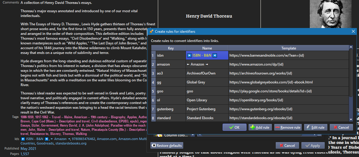

Originally Posted by correoparaappzz View Post
another question, is it posible to do the same in Book Details?
I don't believe so, most you can do as far as I know is to insert some emoji characters like ▶️ at the rules for identifiers dialog:
Name:	MWSnap 2025-01-22, 20_03_13.png
Look&Feel -> Book Details -> Create rules

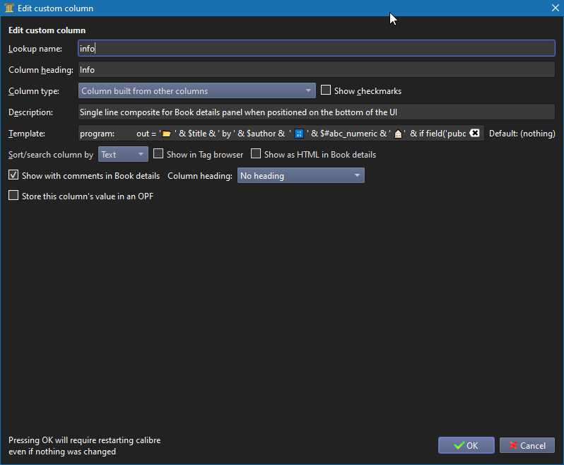

@chaley: ​I went from this on my "Info" column displayed along with Comments field...
📂 {title} by {author} 🔢 {#abc_numeric} 🏚️ Published in {pubdate} by {publisher} 📚 {#pc} 🗓️ TS: {date} 🗓️ LA: {#la} 🗓️ LV: {#last_viewed} ISBN: {identifiers:select(isbn)} 👍Votes: {#v} 👍Rating: {#rr} 🌍 {languages}
to this:
program:
out = '​📂 ' & $title & ' by ' & $author & ' 🔢 ' & $#abc_numeric & ' 🏚️' & if field('pubdate') then 'Published in ' & field('pubdate') else '' fi & if field('publisher') then ' by ' & field('publisher') else '' fi & ' 📚 ' & $#pc & ' 🗓️ TS: ' & $date & if field('#la') then ' 🗓️ LA: ' & field('#la') else '' fi & if field('#last_viewed') then ' 🗓️ LV: ' & field('#last_viewed') else '' fi & if select($identifiers, 'isbn') then ' 🆔 ISBN: ' & select($identifiers, 'isbn') else '' fi & if field('#v') then ' 👍Votes: ' & field('#v') else '' fi & if field('#rr') then ' 👍Rating: ' & field('#rr') & if field('languages') then ' 🌍 ' & field('languages') else '' fi else '' fi
WITHOUT AI... so my head is

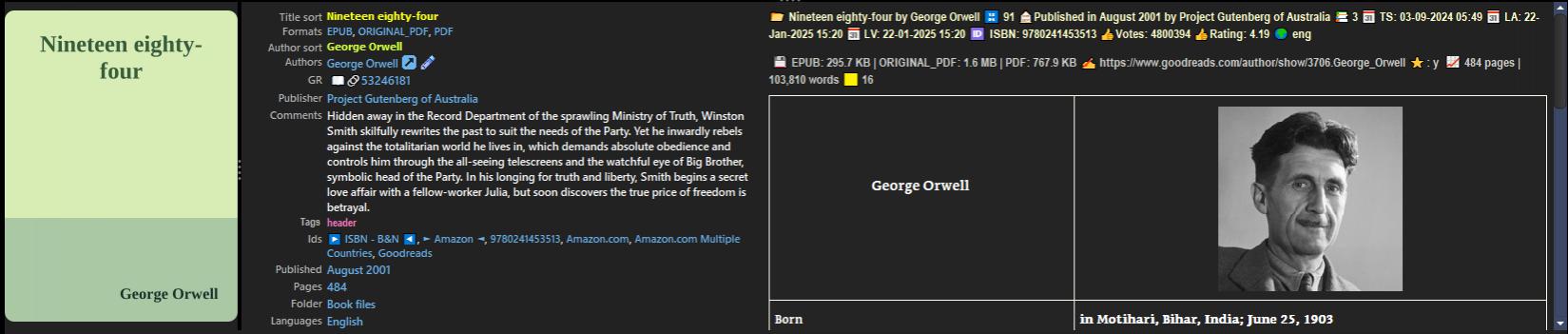

The output in Book Details looks like this:
📂 Nineteen eighty-four by George Orwell 🔢 91 🏚️Published in August 2001 by Project Gutenberg of Australia 📚 3 🗓️ TS: 03-09-2024 05:49 🗓️ LA: 22-Jan-2025 15:20 🗓️ LV: 22-01-2025 15:20 🆔 ISBN: 9780241453513 👍Votes: 4800394 👍Rating: 4.19 🌍 eng
And I also have that other secondary Info column you helped me with the other day, like this:

this one outputs:
💾 EPUB: 295.7 KB | ORIGINAL_PDF: 1.6 MB | PDF: 767.9 KB​ ✍️ https://www.goodreads.com/author/sho....George_Orwell ⭐: y ​ 📈 484 pages​ | 103,810 words​ 🟨 16
I'm finding it fun to assemble these templates but I'd be happy to receive some feedback on overall syntax and alternatives to simplify the code or perhaps convert it to PTM
(the main purpose is to make room for my author Bio column but I also find those lines useful to spot at a glance what metadata is missing that I would like to have displayed)
program:
out = '  �� ';
fmts = list_sort(formats_sizes(), 0, ',') ;
for fmt_data in fmts:
fmt = sublist(fmt_data, 0, 1, ':');
size = sublist(fmt_data, 1, 2, ':');
str = if size ># 0 then strcat(fmt, ': ', human_readable(size), ' | ') else '' fi;
out=strcat(out, str)
rof;
if substr(out, -2, 0) == '| ' then
out = substr(out, 0, -3)
fi;
out
& strcat(
if field('#li') then '​ ✍️ ' & field('#li') else '' fi,
if field('#fav') then ' ⭐: y ' & field('') else '' fi,
if field('#pp') then '​ �� ' & field('#pp') & ' pages' else '' fi,
if field('#words') then '​ | ' & field('#words') & ' words' else '' fi,
if field('#ac') then '​ �� ' & field('#ac') else '' fi ,
if field('series') then '​ ▶️ ' & field('series') & ' - ' & field('series_index') else '' fi
this one outputs:
�� EPUB: 295.7 KB | ORIGINAL_PDF: 1.6 MB | PDF: 767.9 KB​ ✍️ https://www.goodreads.com/author/sho....George_Orwell ⭐: y ​ �� 484 pages​ | 103,810 words​ �� 16
Implemented, thanks

Where do the templates go?
I know it's a modification of the next version but those who have the source code version could post a screenshot of where the template for the category icons or this template would go.
Thanks
Actually what I'm using is available since 2023, I mean, the Custom Column/ Book Details feature that allows templates along with the Comments column:
Name:	2025-01-26 14_46_56-Edit custom column.png
Name:	2025-01-26 14_44_20-Edit custom column.png
Name:	2025-01-26 14_43_57-Edit custom column.png
Name:	MWSnap 2025-01-26, 14_34_49.png
As to the new Category custom icons for the Tag Browser, this feature is already available on latest preview
