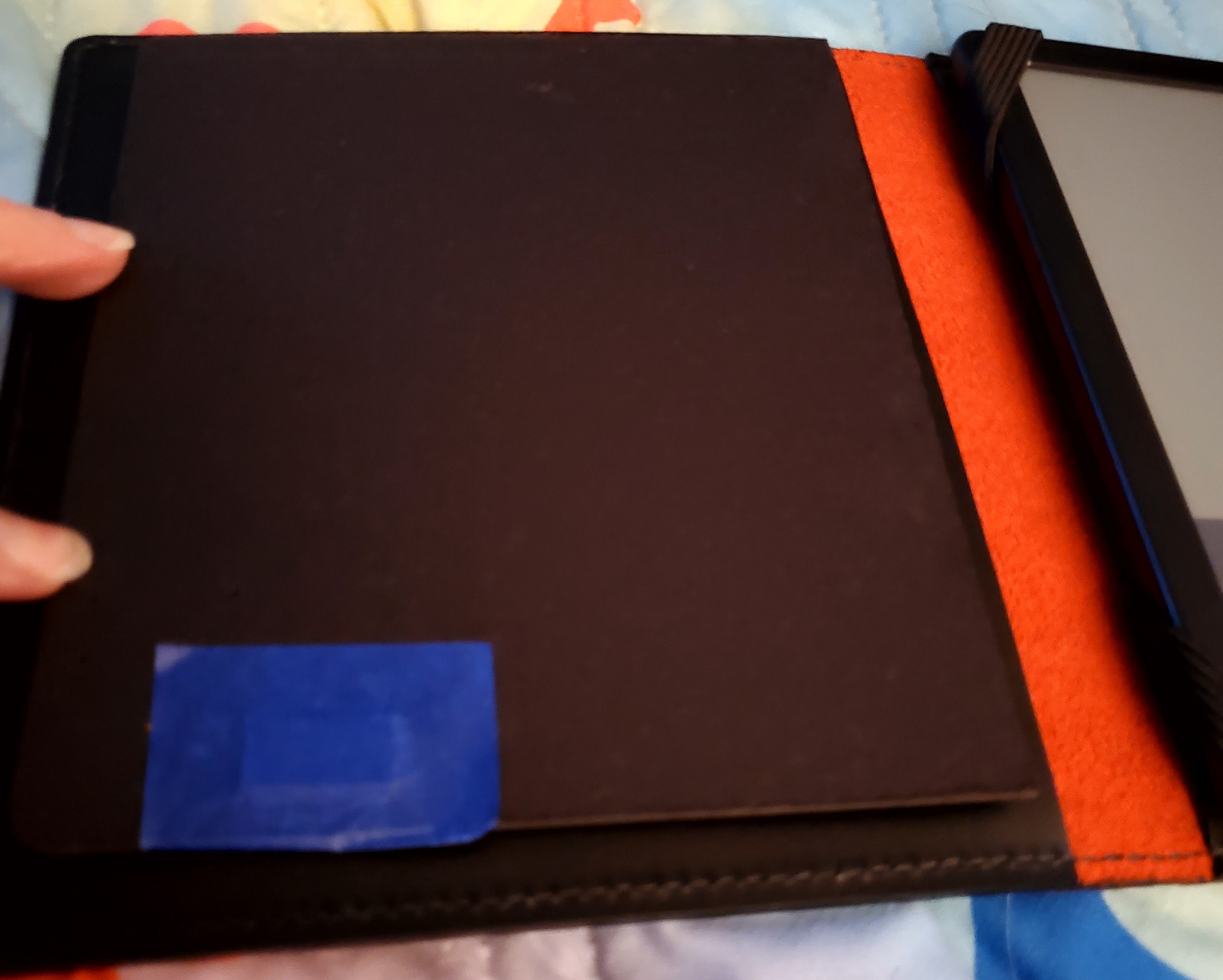

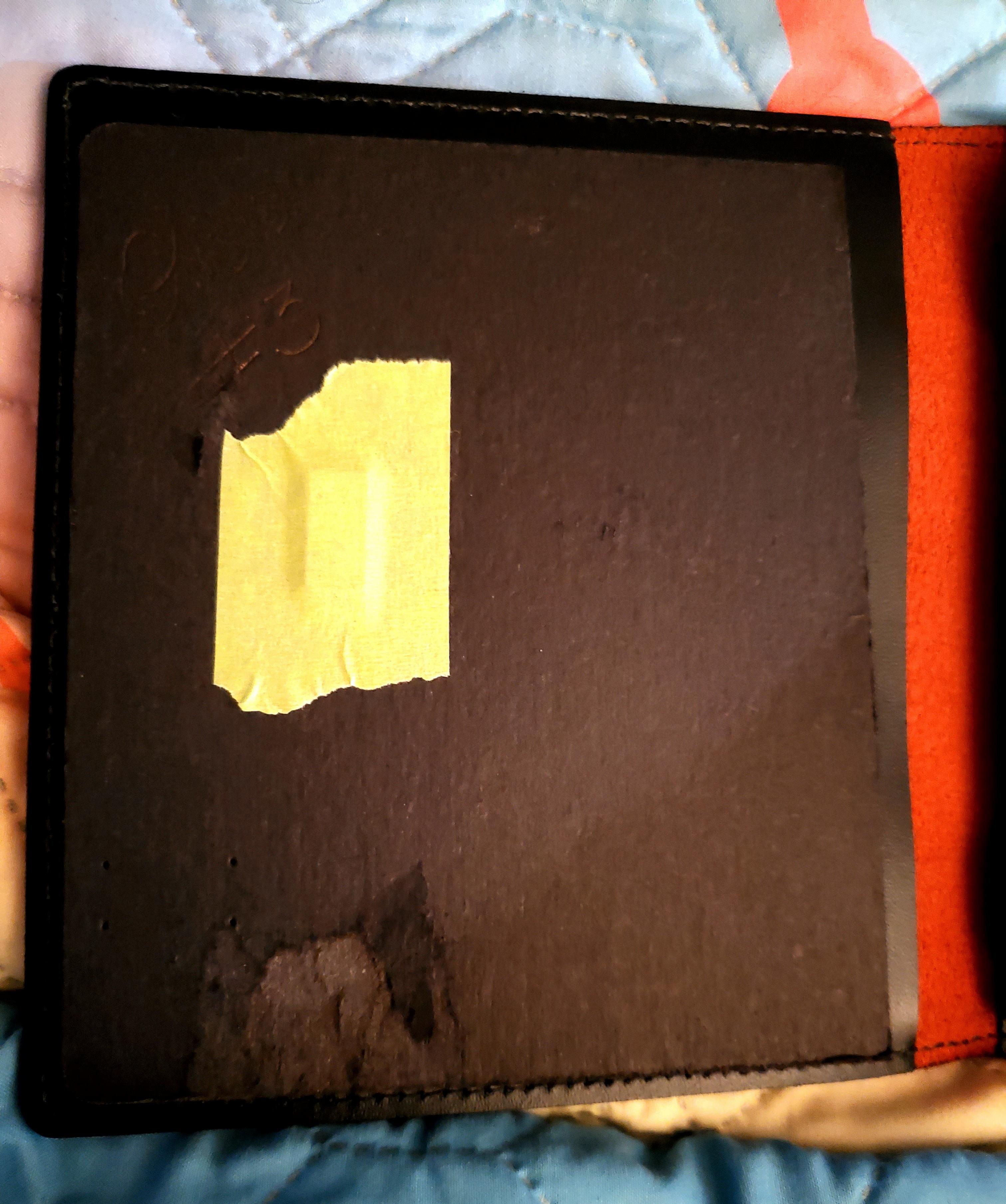

Ok guys I need some help please. Just got my Cloud Dragon Oberon cover for Kindle Oasis to use with my libre colour.
Where is the magnet? In the Oberon cover, in an existing cover made for the kobo, in the libre itself? What does it look like? How do I attach it to the Oberon cover so it stays in place? Sorry, but I am 79 and really need more detail. Thank you very much in advance.

The magnet is easy to move, but it is better to ask Oberon to tape the magnet and NOT glue it in place.
Remove the inside black card (for stiffness and protection).
Remove the tape. If magnet has been glued, pry the magnet up carefully, and move it to the spot between my 2 fingers in the photo. But put the magnet IN about 1" or 1.5" from the edge of the glass. See photos. Tape in place. Painters tape works great.
When closing the cover, the magnet must touch the glass so slide the black card back in the correct way.
1st photo is where Oasis magnet is.

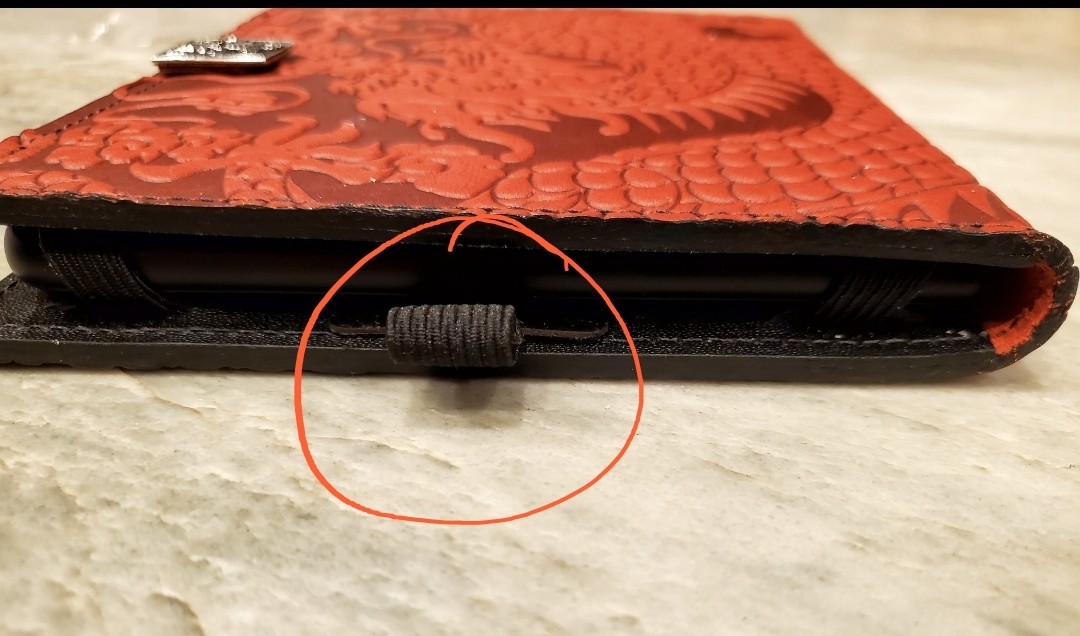

Photos of the pen holder.
Pen holder will not fit on the spine, so I put it on the top. Cost is $5.00 but it is nowhere on the website. Call or email to order it. Black only. Has a sticky back. I do not have the correct pen, but I used another pen that works.
Technically it is a pen holder, but I use it for the stylus. Ask for pen holder.

Ok, found and moved the magnet, all works like it should. Checked Power Off never, and it works like a charm. Thank you guys.
