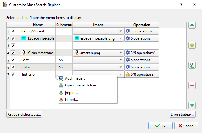

No, it's really not a problem to do this repair.
Can tou share the operations list that raise the error with the export tool.
