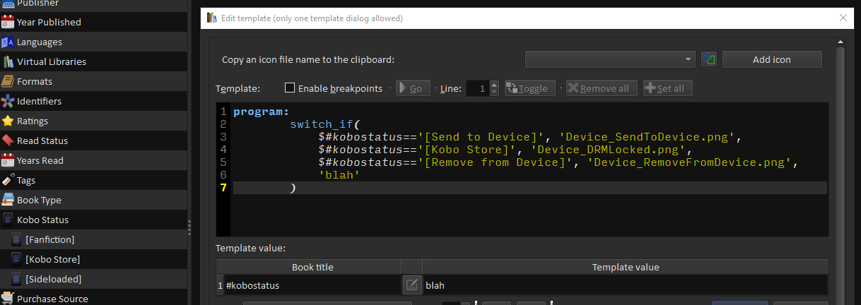

is there a reason its not working?
Name:	2025-01-16 17_10_43-calibre — __ My Books __ On Device __ On Device __.png
ID:	213103   Click image for larger version
Name:	2025-01-16 17_11_05-D__AppData_calibre_tb_icons_template_icons - XYplorer 23.80.0200.png
You didn't read the documentation I posted above. The template doesn't have book metadata available because the values in the tag browser aren't books. The template has the category name and the category value. I think that in this case instead of looking at #kobostatus you would look at something like
$value == '[Send To Device]'
This works because templates are category specific.

Old 01-16-2025, 04:23 PM   #20
ownedbycats
Custom User Title
ownedbycats's Avatar
Posts: 11,635
Karma: 81412473
Join Date: Oct 2018
I added a template then accidentally 'restore default category icon' which reset the default column icon. When i tried to put the icon back it didnt work. (no popup)

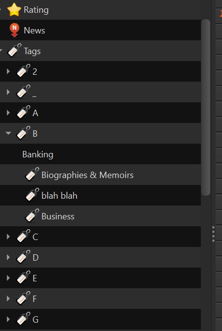

I had no expectations but I was hoping that the category item icons would be shown in book details, so I gave it a spin.
After adding a category item icon, it wasn't obvious to me how I could remove it; so, I used brute force and deleted it from tb_icons, when that didn't make it go away I guessed it was cached so I restarted calibre… et voilà, gone completely:
Name:	Screenshot 2025-01-17 212642.jpg

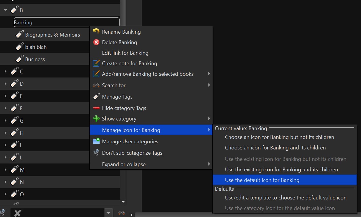

I now know that the way to remove a category item icon is to select the Manage icon for <item name>->Use the default icon for <item name> option, viz:
Name:	Screenshot 2025-01-17 214027.jpg
But seeing that icon free "Banking" leads me to ask: Would it be possible to provide an option that hid all icons in the Tab browser apart from the top level category icons? For me they are distracting space wasting clutter.
Name:	Screenshot 2025-01-17 215219.jpg
I'm not going to add an option to turn off icons under a category.
However, you can get most of the way there by adding a template for the default. If the template returns a non-existent file name then no item values will have an icon unless overridden by some other rule. The category and the partitioning entries will still have the category icon.
I just tried it with this template
program: '--'
I got this:
You could also do it by making an empty icon and having the template return that.

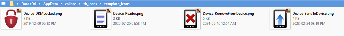

I got the Kobo status figured out. Good that it carries over to my @On Kobo custom category.
Name:	2025-01-17 07_44_45-calibre — __ My Books __ On Device __ On Device __.png
Old 01-17-2025, 06:47 AM   #25
chaley
Posts: 12,529
Karma: 8075938
Location: Notts, England
Attachment 213122
Did you use a template or individual rules?
Old 01-17-2025, 06:47 AM   #26
ownedbycats
Custom User Title
Posts: 11,635
Karma: 81412473
Join Date: Oct 2018
Template.
program:
		switch_if(
			$value=='[Send to Device]', 'Device_SendToDevice.png',
			$value=='[Kobo Store]', 'Device_DRMLocked.png',
			$value=='[Remove from Device]', 'Device_RemoveFromDevice.png',
program: '--'
I got this:
Attachment 213121
My suggestion was to hide category item icons for all categories, not hide them a per category basis, but your trick gets me most of the way there, maybe I can 'hide' the partition icons with a transparent icon.

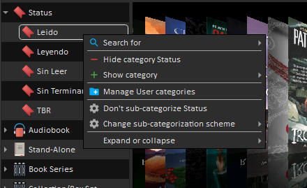

Old 01-17-2025, 02:38 PM   #30
correoparaappzz
correoparaappzz began at the beginning.
Posts: 71
Join Date: Nov 2023
Device: Kindle Oasis
In the tag browser, right-click on the category of interest. Choose "Manage icon for this value" then choose "Use/edit a template to choose the default value icon".
See post 7 for documentation of this new feature.
I don't see any of those options
Name:	Captura de pantalla 2025-01-17 113640.png
