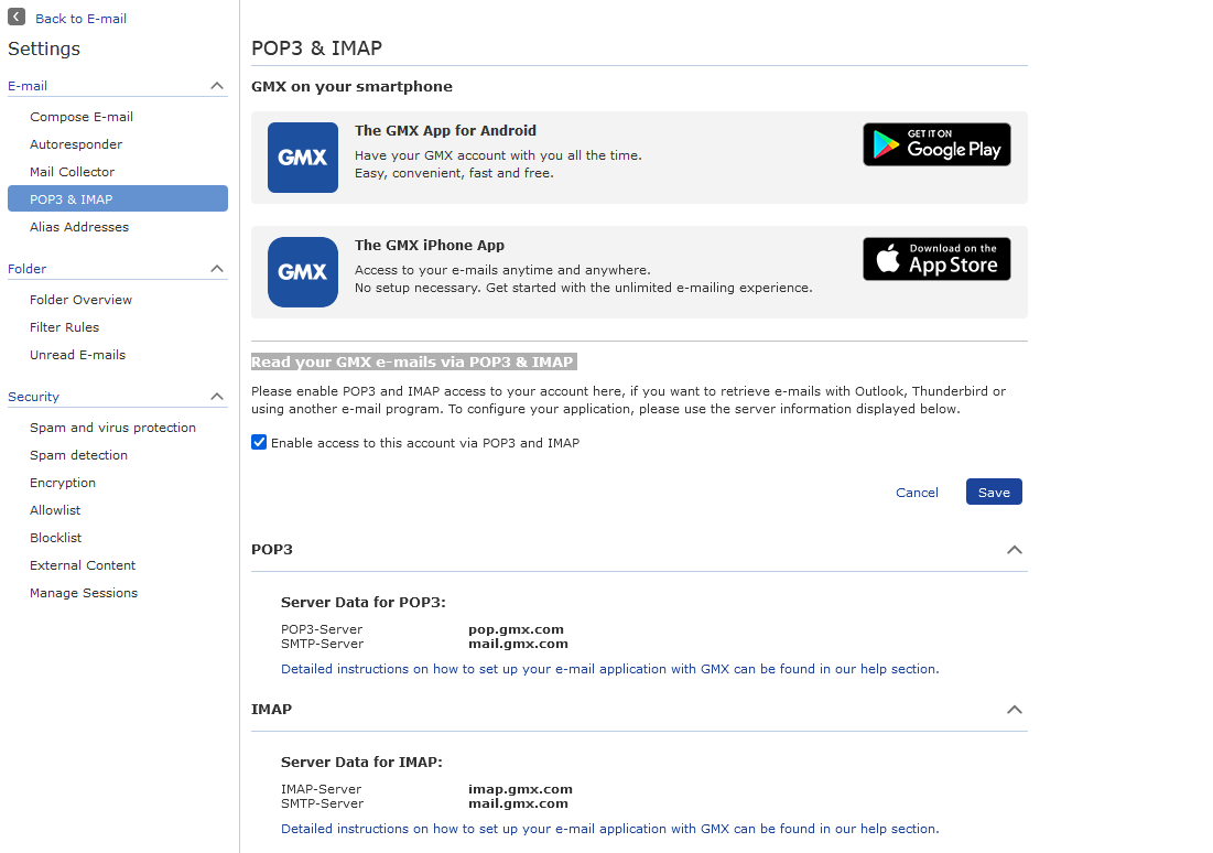

Also in your GMX account, in Settings => POP3 & IMAP, under the Read your GMX e-mails via POP3 & IMAP header, did you check the box beside Enable access to this account via POP3 and IMAP?
Name:	Screenshot 2025-01-13 115602.png
