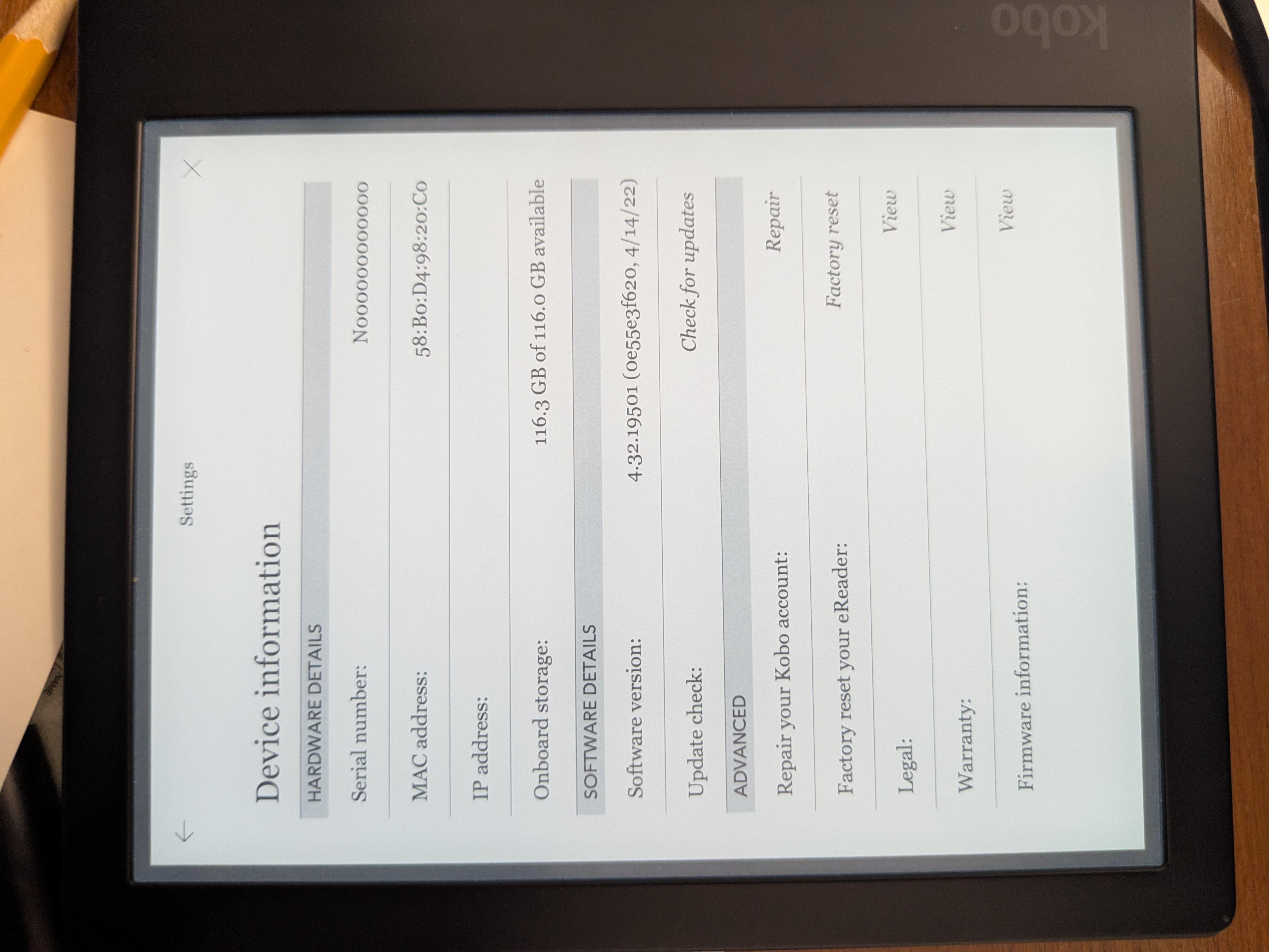

I was in a similar situation as cowchair with my Kobo Libre. I flashed the revision E image onto a new microSD card using dd and gparted to expand the FAT32 partition.
It worked, but unfortunately I'm unable to update the software anymore. It checks for updates, downloads the update, but after restarting its stuck on the same version. I got past the setup stage using these instructions: https://yingtongli.me/blog/2018/07/30/kobo-rego.html and tried manually updating by extracting the update into the .kobo folder, but still no luck.
It's stuck on software version 4.32.19501. Also has a blank serial number.
As of now the eReader is still usable with Calibre, but unfortunately I can't download from my local library with overdrive, as syncing from overdrive also triggers a software update check.
Did anyone have this same problem?
Have you tried a manual firmware update after downloading the firmware from https://pgaskin.net/KoboStuff/kobofirmware.html
Yes, I tried with a couple different versions, downloading and extracting to .kobo when the SD card is mounted.

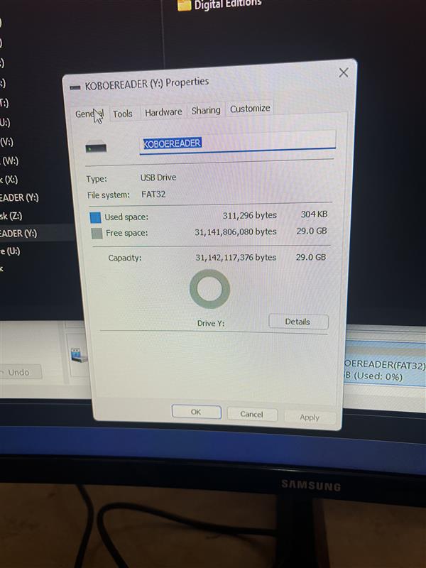

hi guys, My old SD card is broken, so I have to reflash the img into my Kobo Clara 2E. thanks David for helping me out with the img file.
However, no matter how hard I've tried, the device is not turned on, and LED indicator just keep blinking forever and non-stop.
My steps were:
1. Download img David sent
2. Format new sd card
3. Use FlashDriveImage writer to write the img file into SD card
4. It shows 3 drives, I extended the SD card storage (KOREADER) by MiniWizard Partition
5. Input back into Kobo Clara 2E
6. It won't boot up and LED keep blinking
I tried to again and again and again.... 2-3 times but no luck. I can be sure that I did the steps very careful. I don't know what to do now. I charged it for an hour but no hope.
Any suggestions/help are highly appreciated, thanks a lot
