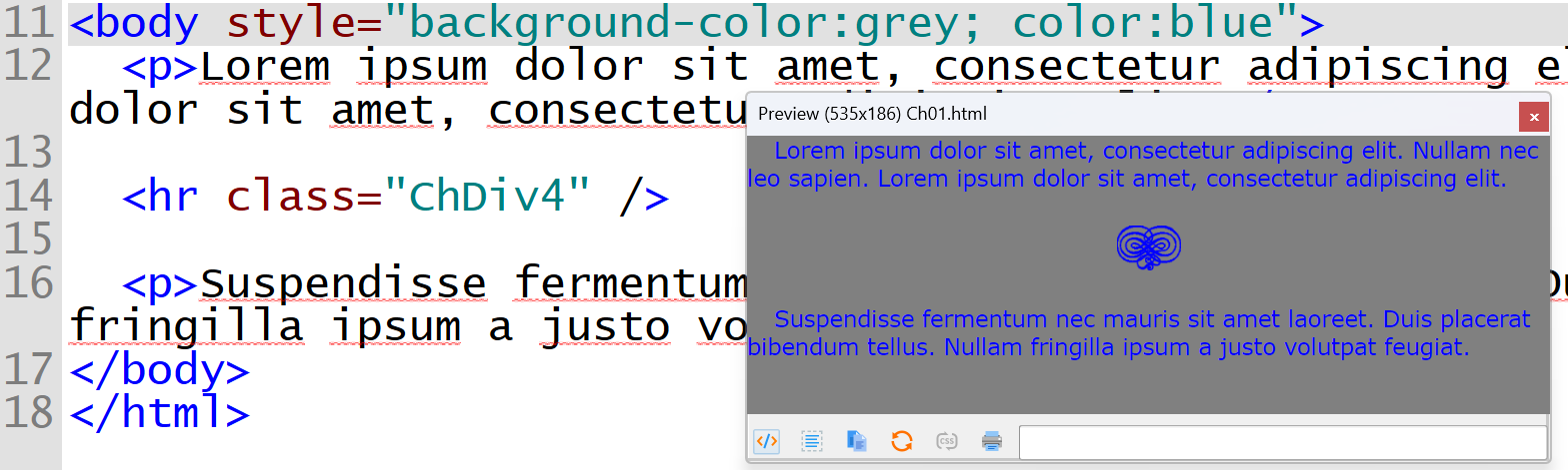

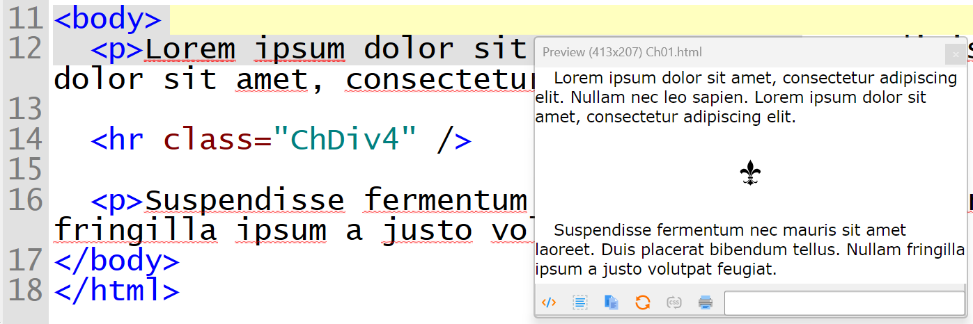

Here are a few screenshot examples:
Name:	Screenshot 2024-12-05 113830.png
ID:	212356 Click image for larger version
Name:	Screenshot 2024-12-05 113906.png
ID:	212357 Click image for larger version
Name:	Screenshot 2024-12-05 113944.png

And for the OP's original question about a fleur de lis, using a mask:
Name:	Screenshot 2024-12-05 151115.png
ID:	212365 Click image for larger version
Name:	Screenshot 2024-12-05 151102.png
