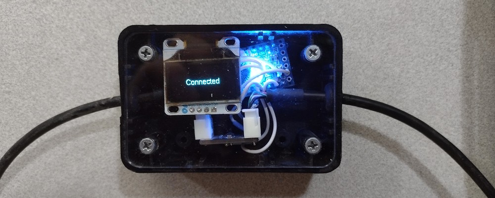

You can make your own EDL cable too. Just make sure to leave the red wire alone. There are instructions online.
The Poke3 doesn't work with an EDL cable, the Poke5 does. I never even checked my Go6 since I built in a magnetic EDL switch anyway. But the Go6 does work with an EDL cable. I built an automatic "EDL cable" (that's a box) where you don't even have to push a button or get the timing right.
