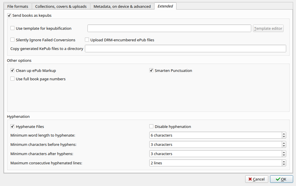

I've never used the 'Set KePub hyphenation'. If you're a calibre user can't you use the hyphenation options in the KoboTouchExtended driver to control kepub hyphenation?
I set hyphenation on for all of my books in Calibre, but it only works if I use full width justification. This is causing well known non breakable space width issue and makes all the dialogs look ugly.
So, I am using “Set KePub hyphenation” patch to allow hyphenation with left justification. This preserves the width of the spaces, but also reduces the jaggedness of the right edge of the text.

I don't use the kepub hyphenation patch. Instead, I use the Extended tab in the KoboTouchExtended plug-in. See the attached image.
I also use JSWolf's Better Hyphenation dictionary (which should be installed AFTER patching).
Correct me if I’m wrong, but this will still not work with left justification, right?
The patch Description for 'Set KePub hyphenation' states
(The publisher can still turn hyphenation off/on in the book's stylesheet.)
which implies hyphenation CSS contained in the kepub's own CSS sheet(s) will be used. The KoboTouchExtended driver's hyphenation option forces extra CSS code into each kepub during calibre's send-to-device.
Another option is to use the 'Modify CSS'/kobo_extra.css feature included in both the KoboTouch & KoboTouchExtended calibre drivers, documented here. This will let you append any CSS rules you like (hyphenation or otherwise) to the bottom of every CSS sheet in the epub/kepub during calibre's send-to-device.
Thank you! This is super useful. I will try to experiment with CSS and see if hyphenation works for me without the patch.
