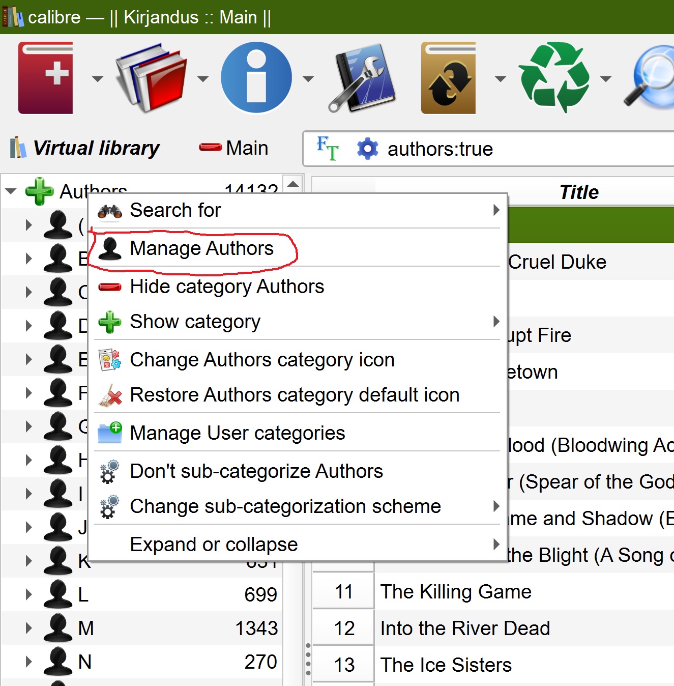

By manually editing your author names and titles. For authors, you can use Manage Authors by right-clicking on the category Authors in the tag browser (I've added a screenshot). Make sure there is just one variant of the name per author (not, for example Peter M. Williams and Williams, Peter M. and Peter M Williams, all of them meaning the same person).
For titles, it's one by one. Make sure all documents by the same author have different titles.
