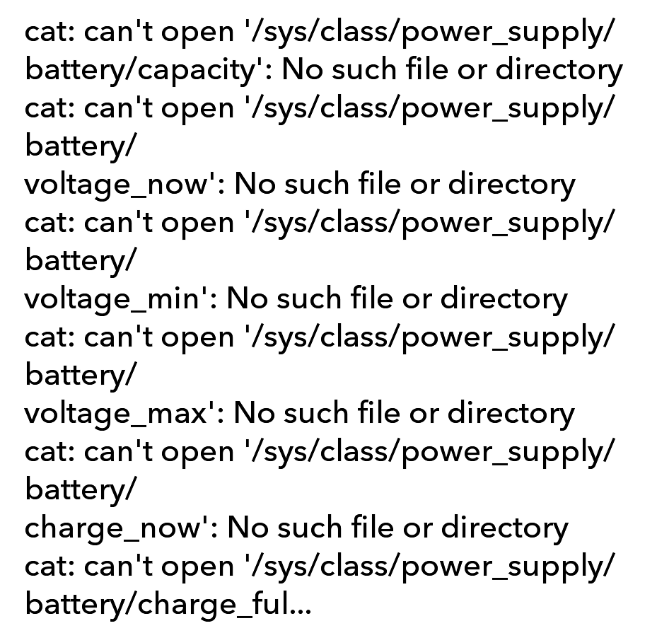

Thank you. Using this script with NM does not work in my case....I get several error messages of NM....
