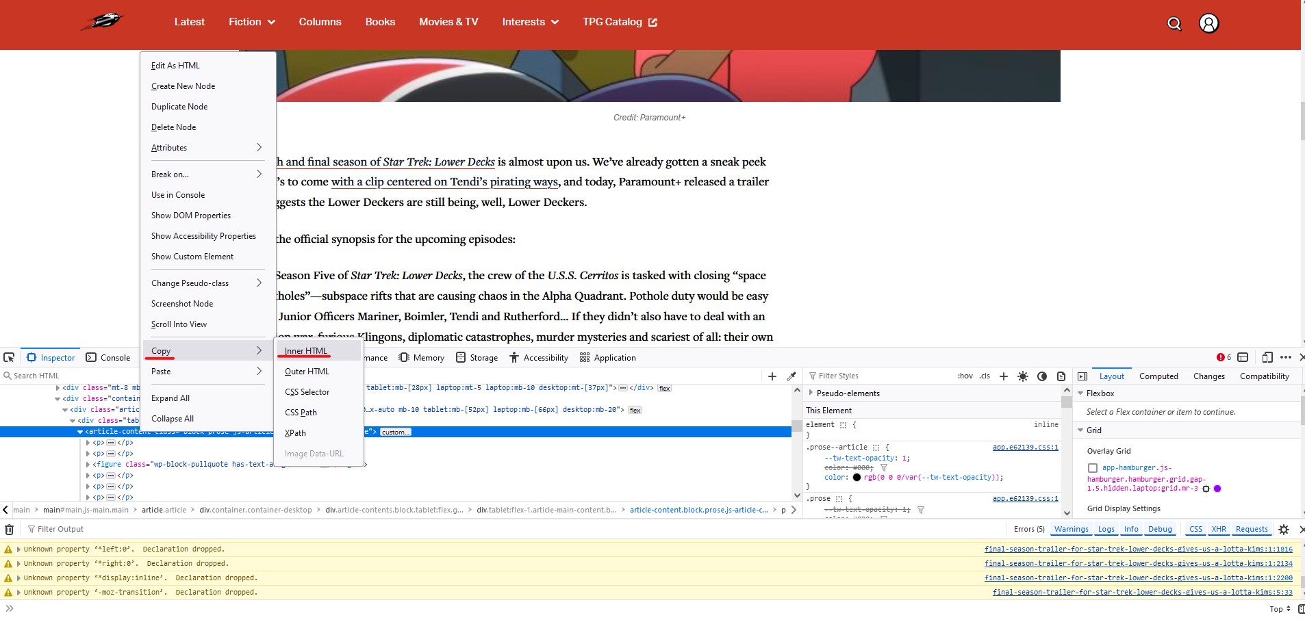

You should be able to right click on the start of the text and select Inspect.
Then, scroll down the <div> until you hit the one that causes all the text to turn blue
Then context menu > Copy > Inner HTML.

Thanks. Is there no easier solution?

There probably is, but I am not aware of them.
